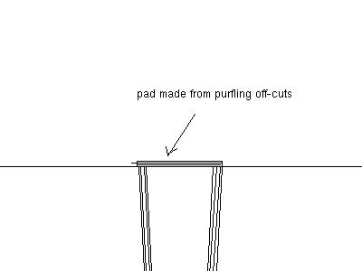

Take three off cuts of your perfling and glue them together to make a little pad that is the exact height of the perfling. With a tiny piece of very thin carpet tape, secure the pad to the top of the guitar above the graft. The length of the pad should be the width of the graft as it meets the binding. Set your router bit depth to the width of the binding plus the perfling. When the router gets to the end graft, slowly slide it up over the pad.
Do the same thing for the back but make the pad shorter because the graft is shorter there.
The channel will require a bit of clean up with a chisel since the change in height of the router will be governed by the collar and not the bit itself. But at least you can't forget and route through.
You might want to scrape the pad a little bit thinner to compensate for the thickness of the carpet tape.
