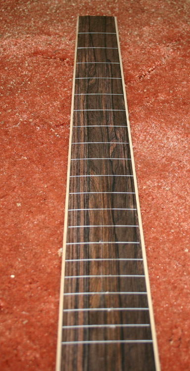

Hi Guys
I have a guitar that I am making that has some beautiful Spidersweb Old Growth Brazilian as the fingerboard, Normally I use a lemon oil as a final prep for my fingerboards, this works great normally, but I tested a bit on this piece of wood and it just duls all the colour and kills the spidersweb, Does anyone have an alternative ?
Many Thanks
Russ

Thanks Guys I think I am sorted now, I am either going to just polish it with micromesh, and if need be go with a small amount of wax, one of the beauties of this piece of wood is the colours and contrast so I don't want to darken it anymore than I have to.
