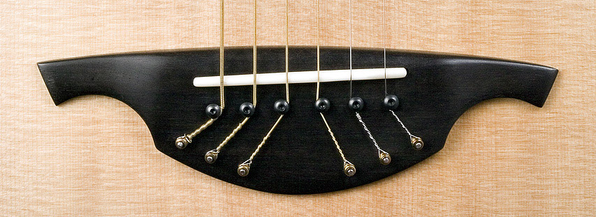

Not all pinless bridges are really pinless. Here's a pic of mine which is an adaptation of Steve Klein's design. There are no bridge pins, but there are pins which the ball ends of the strings fit over. They go all the way through the top and the bridge plate. I build both pinned and pinless bridges and I can't say there's any difference in tone. I've never had any problem with either type of bridge lifting off the top.

That's one awsome looking bridge Jimmy.

Jimmy,
Great design!
I like the button heads. Do they go as deep as the pins?

The button heads do not go through the top. The are secured by t-nuts which are recessed into the bottom of the bridge.
