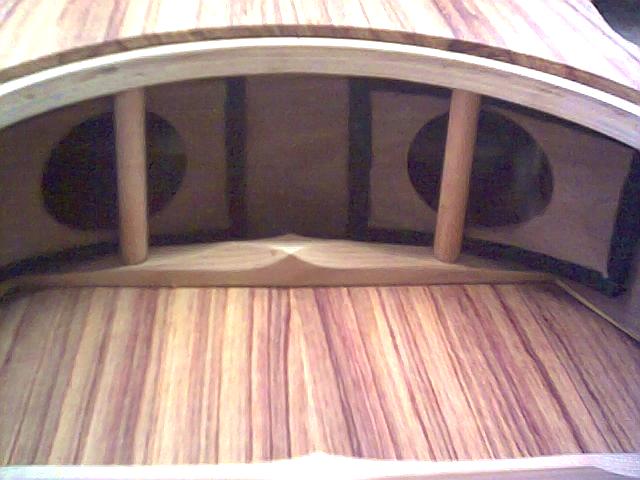

This question is for all---I would like to see some of the different baffle designs used for reso guitars.can anyone oblige?thanks!---Jerry

I am making some photos today of one I am working on and I will probably have them up this P.M.
PostPosted: Mon Oct 03, 2005 2:27 pm
Posts: 244
Jerry, Here is the photo that I promised. Poor photo quality but maybe you can see it ok.
PostPosted: Tue Oct 04, 2005 12:59 am
Cool braces D.L. !

Thanks Daniel---that is the canary wood you told me about isnt it?really looks good---how thick is the baffle?and what is it made of?
PostPosted: Tue Oct 04, 2005 2:51 pm
Posts: 244
Thanks Don, The braces look a little hefty in the photo.
Jerry, Yes that is the one. This is a three piece adjustable baffle. Made from walnut about 2.5 mm thick and bordered with felt to avoid any wood to wood contact.

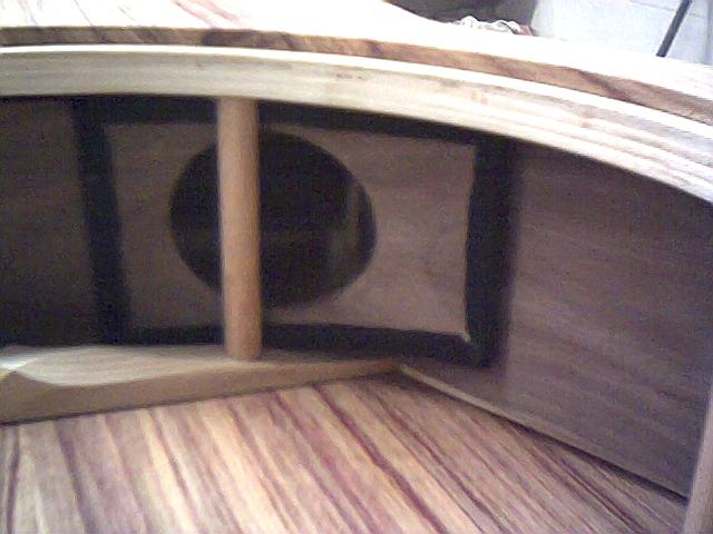

This photo shows the side that the baffle contacts so the felt can maintain a good seal. This seperates the upper and lower chambers.
