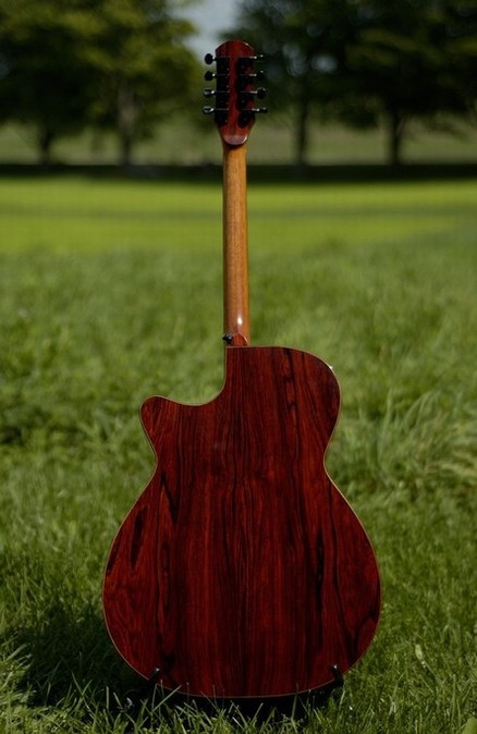

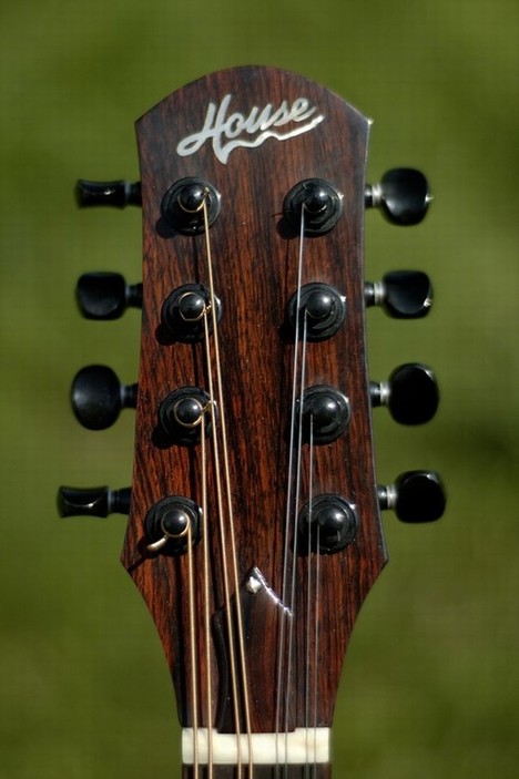

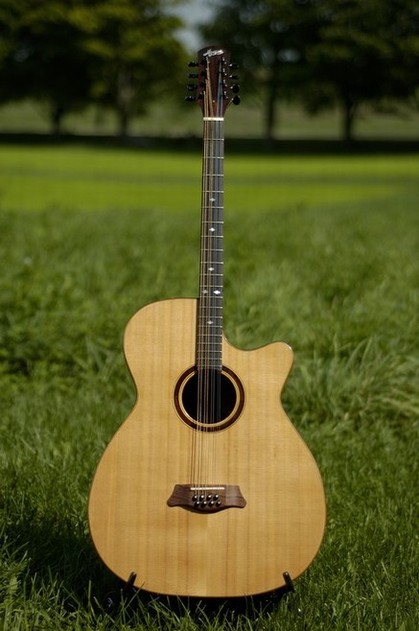

It has been a while since I have posted pictures of my work so I thought I would put these up. I finished these instruments off a few months ago and thought people might be interested in seeing the bouzouki. About a year ago a friend of mine approached me to build him a guitar-bouzouki. I had no idea what one was or what kind of measurement you would use. So we started with a guitar shape and came of with the rest of the neck dimensions together. The instrument was a great success and I decided to build another. I changed a few things from the original design and that is what you see hear. The design still needs to be refined a bit, but it is a great instrument and a lot of fun to play.
Here is an overview of what you are looking at
Shape-OM
Wood-Cocobolo b/s, Cedar top, Brazilian appointments all around
Neck-scale 24.9, 12 frets to the body
-dual side sound ports
Machines – Gotoh steel minis
Tuning – GDAE, or a bunch of other bouzouki tunings
Since building this I have bought a copy of the Bouzouki Book which provides measurements and plans for a traditional Irish Bouzouki. The string spacing I have chosen is much tighter than a traditional bouzouki, which allows for a lot of speed and a really comfortable feel. The side ports add a lot to this instrument and I can’t say enough about the benefit of side ports in our instruments. They do wonders for the tone.

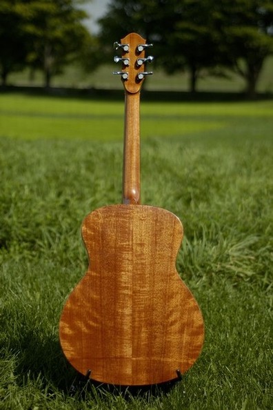

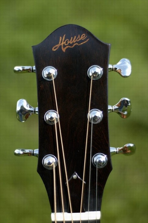

These are some pictures of a Mahogany/Sitka guitar I built. Very plain and simple, but what sound! I have not built many Mahognay instruments but now I’m hooked. This thing sounds great! I am sure I will be using Mahogany a lot in the future.

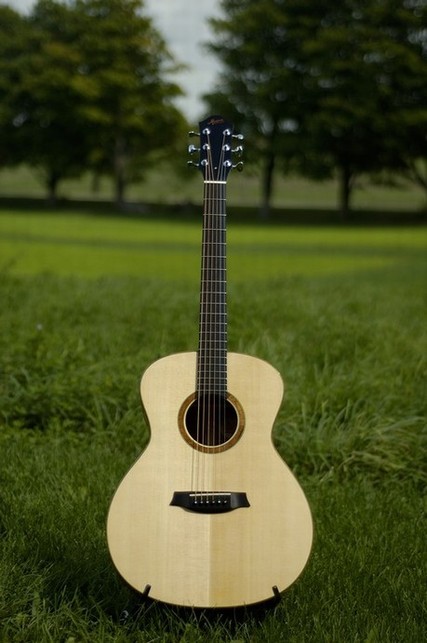

That guitar bouzouki is fab!! What string spacing did you use? I love guitar-bouzoukis they make such great music. The sound ports look good - I'll have to try them out on a guitar bouzouki, I love them on guitars. The guitar looks really sweet too - I love mahogany.
Here's some pics of one I made earlier this year in Euro spruce/EIR. It's a 16 fret body join ( a la Sobell) which gives great upper fret access, and has 25.75" scale length. I play it in GDAD tuning. Pardon the picture of saddo me, but it was pictured "in action" in a full blown Irish Session!

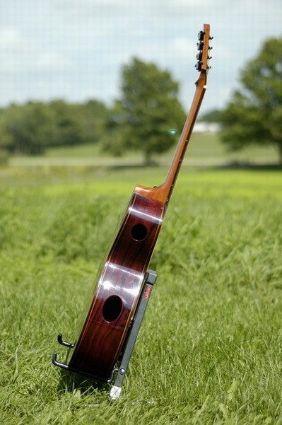

Josh, are there 2 ports on that side?
The picture is pretty dark on my screen, and it's a bit hard to see clearly.

I remember reading in one of your other posts that you build guitar-bouzoukis. Thanks for chiming in and posting pics. The first thing that came to mind when I saw the pictures was, “that looks a lot like a Sobell.” I had a good oportunity to examine a Sobell guitar-bouzouki last month at our local Celtic Festival here in town. One of the performs James Fagan, (www.kerrfagan.com) had one and we compared the two instruments (Sobell and mine) side by side. It was great to hear a good bouzouki player play my bouzouki. I still can’t play much on it. Anyway, the Sobell had a more traditional spacing like yours. To me the neck felt more like a guitar neck, while mine has a bit of mandolin feel to it. My bouzouki is 34mm wide at the nut with a string spacing of 28mm or 1 3/32” at the nut. The spacing at the bridge is 37mm or 1 15/32.” The spacing is actually taken of the middle 4 courses of strings from his 12-string guitar. Fagan and other professionals who have played it say that the neck is certainly narrow compared to there standard instruments. Yet most of them really like it and have said it is great for playing tunes. Your picking hand doesn’t have to jump as far between strings which allows for greater speed. Fagan also thought the side sound holes added a lot.
The number of frets to the body joint is an interesting issue. Most of the guitar-bouzoukis I have seen are like yours, having more than 14 frets to the body. That is where my 12-fret design seems to differ a lot from what other people are doing. I like where the bridge ends up because the of 12-fret neck. I think it really contributes to the tone. I added the cutaway to give some more access to the higher frets.
I appoligize for the poor pictures there. There were taken in a hurry. Yes, there are 2 side sound holes on this instrument. The inspiration behind trying 2 came from seeing the guitars of Allan Beardsell and Michael Greenfield. It really does make a difference having 2 instead of just one. I found that it gives an almost “stereo” effect that you don’t get with just the one port. There is lots of room for discussion about how big and where the holes should be placed, but I really like have the 2.

James is a fantastic player and James and Nancy concerts are great - they compliment each other so well. James has played the guitar bouzoukis I have made and is very good at giving a builder constructive feedback. Scale length and string width is a moveable feast with "Irish" bouzoukis - they are relatively modern, originating in the early 70's when Andy Irvine wanted something like the Greek bouzouki (short scale length) with more volume, and Stefan Sobell made him a guitar bouzouki with a guitar like scale length. Funnily enough the bouzouki is regarded as more "traditional" than guitar in Irish music circles!! Most bouzoukis I've played have nut width of around 37-40mm. I prefer more width and made mine with 44mm spacing.
I'm not sure that the bridge position is that much different in the lower bout on yours - you do have more body volume though. However, the higher frets are used a lot on guitar/bouzoukis (probably more than on guitars) and the lower strings are used up here almost as much as the high strings. If you have seen James play, then you will have seen the chord shapes with a partial barree on the lower two strings, the 2nd string fretted one or two frets higher and the 1st string left open. This shape is used well past the 12th fret and I suspect this would be difficult to play on your guitar bouzouki. This is why the 16 fret join works so well.
The more "traditional" bouzoukis have a different sound - more nasal and cutting, and not as well rounded as in guitar bouzoukis, and also you get different sounds with the fixed and floating bridges. I prefer the sound of the guitar bouzouki but both are nice. Also the balance of the traditional designs is very different - more neck heavy.
