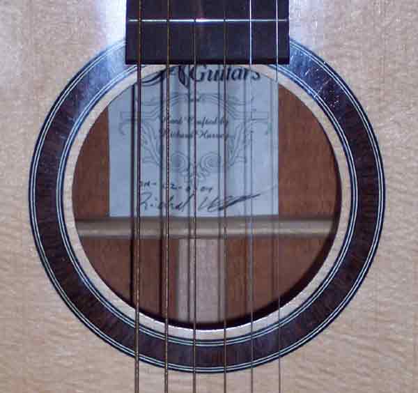

When I make Wood Rossettes I mitre cut a bunch of pieces just like you would pearl and inlay it. It is a lot of work but the grain is then wraping the whole way around the circle. Here is a picture of one I did from Rosewood, Not sure if you can see the detail but this is made of around 50 or more little pieces of rosewood. A real pain to do and not worth the work but some people like it. With Snake wood you could really get a neat effect.

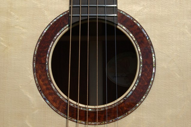

I'm with Paul. Due to the price of snakewood I want to be very careful how I use it. I make my rosettes using 6 pieces cut at a 60 degree angle. If you use the same piece of wood for the whole rosette it usually comes out looking very good.
Here is one of mine. To be honest this one could have been matched a little better....but you get the idea.
