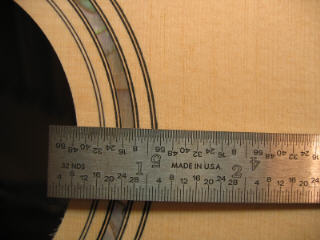

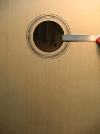

Do you have a pic you can post of a good example of your Master Grade Luts spruce??
I would appreciate it.
Walter
PostPosted: Mon Sep 26, 2005 1:36 pm
Hi Walter,
Sorry for the delay, I was in the bush all day today. I don't have any master grade, having said that all of the wood I have sold people really like but I think there is another grade yet out there so I won't call my stuff master grade. I will take a picture of a top I am working on now and post it in a bit. Spruce is hard to photo, especially when you have to reduce quality to 150K but I will get it up for you. THe wood I have I call 'AAA'. Grain counts are 40's in the tight to 20 or so on the outside. They are stiff and well quartered with virtually now run out.

I took these pictures of a top I am working on with the rosette installed. This a typical 'AAA' set. I hope there is enough detail to see the wood. It is difficult to photo quality spruce because there is no funky figure to show off!
I hope enough detail shows through to get an idea of the wood.

Thank you Shane for the nice pictures. The wood tops look really great.
I appreciate you taking time to do the photos.
I will buy some soon!!
Thanks again.
Walter
