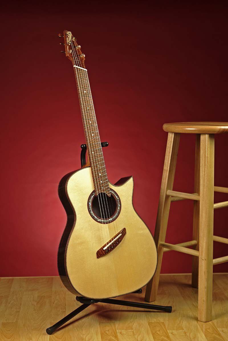

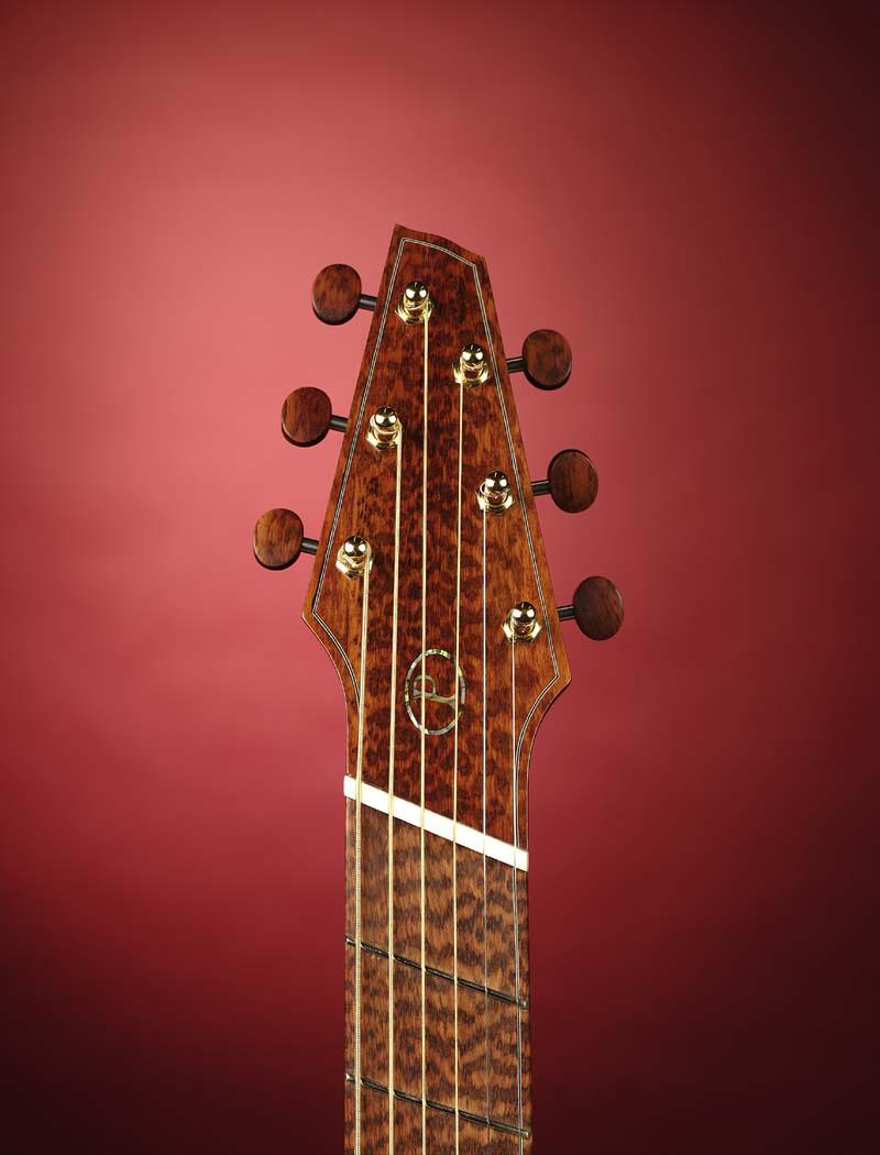

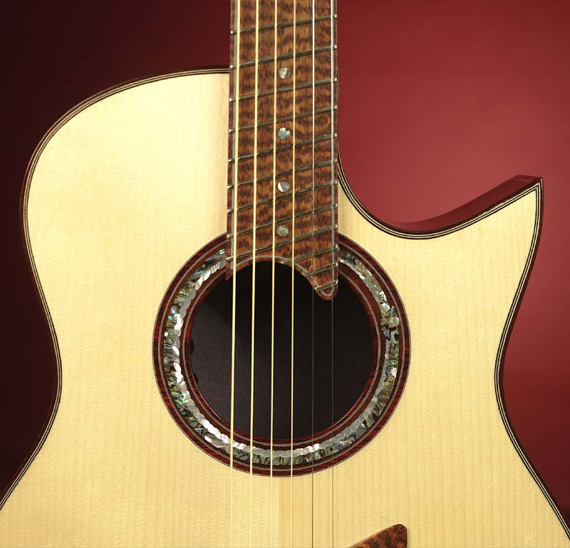

I just delivered one that had all snakewood (that I got from Bad Brad Goodman), I used EIR and Adirondack on the top and I think it looked great.
My one caution is to make sure that the piece for the bridge is STABLE and has no cracks, brad's piece was just about perfect but I left lots of meat on that bridge just in case because snakewood likes to move and split. The fingerboard has two carbon rods all the way down to the tongue to keep it flat.

PostPosted: Sun Sep 25, 2005 12:52 am
Well this changes my current thinking. Started to work on Mahogany back/side set but after looking at this, I will now switch to EIR for this build. Thanks so much for sharing. Absoutly stunning work!!!!!
Question, how did you make the rosette? Did you glue up some snakewood and then use a circle cutter to cut rosette or did you miter pieces? Would love to follow your approach here.
This is an area I am sure others would be very interested in if you are willing to share details and pictures. I am wrestling with this as it is pretty difficult (and expensive) to find snakewood wide enough to glue up and circle cut - and all the expensive waste!!!
