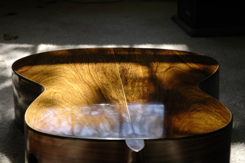

Okay, here's a purposefully bad photograph, intended to show the gloss. I started this back at 9:30 last night, and went until I pooped out. I don't know, maybe 1 1/2 -2 hours? Anyway, the back is not finished because I ran out of time, so I need to do a bit of level sanding, and then do a bit more build and then spirit it off. But, this is what you can accomplish in a few hours of work.
rlabbe38524.3989583333

That's very cool, Roger. Can't wait to take the class.
I've got the Fernandez FP video and it's pretty good, but it was pretty daunting because it seems like it will take forever to finish a guitar that way.
How many and what size of pieces did you bring to the class? So far I'm just planning on bringing some unjoined tops and backs.
