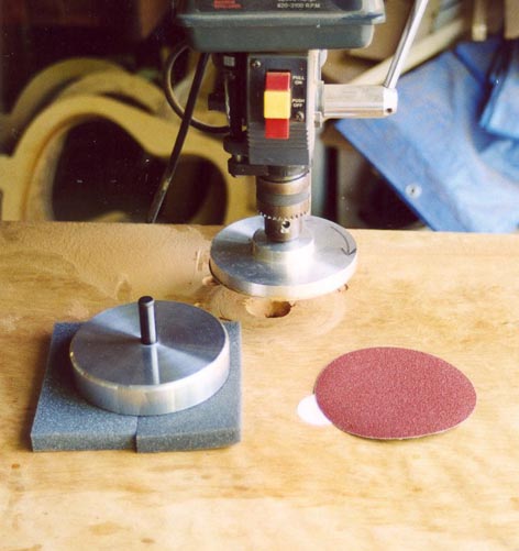

Here's a thickness sanding disc you can use in your drill press:
And here is the link to the maker of these.
Sanding Disc
He doesn't show them on his website but if you email him he'll make one. Considering how much a thickness sander is, this is an inexpensive option when you're starting out.
PostPosted: Mon Jun 20, 2005 1:17 pm
Roy, thanks for the picture. I can see several uses for the sanding disc. I was going to purchase a safety planer but think I'd get more use out of this. I will definitely contact them about a purchase. Thanks again.

[QUOTE=Don A] Roy, thanks for the picture. I can see several uses for the sanding disc. I was going to purchase a safety planer but think I'd get more use out of this. I will definitely contact them about a purchase. Thanks again.[/QUOTE] Hey Don, I've been taking a few pictures at home of the various way I use this great tool, with plans of posting a mini-lesson on here. Hopefully I'll have something ready to go in a few days. I use this tool to make bridges, dimension nuts and saddles, thickness braces to their final dimension, etc. With a few jigs you can really get a lot done. I have two - I keep 120 grit on one, and 320 on the other, so I can either hog off material or get a pretty nice finish, depending on my aims.

Roger, I'm looking forward to your lessons. I emailed yesterday and am waiting to hear back from them as to availability.

This is a terrific tool. It will sand small and large parts. But, make it even more useful by putting a piece of leather on the top, flat surface. Then you also have a great tool to hone chisels and keep them razor sharp right at hand. It is so useful to me that I bought an $80 drill press and dedicate it to this tool with the leather top. Use it every day!Sylvan38525.4186458333

Thanks for the tip Sylvan, I'll definitely give it a try. I received an email from Gilbert Tuners and they cost $50. Seems like a bargain to me. I can sure see where they would be very handy for headstock and volute work.
