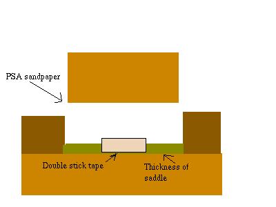

Lance, Try this jig!
The pinkish rectangle is the saddle blank.
THe PSA sandpaper does not extend the full width of the sanding block.
Mike Mahar38517.3554976852
