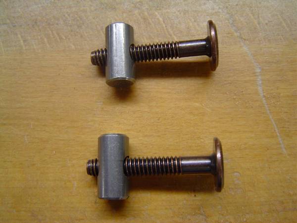

I don't like the brass inserts. Their threads are too small. The zinc ones are slightly tapered, have bigger threads and you drive them in with a hex wrench. I've never had one of the zinc ones strip.
Here's a picture. I get mine at my local hardware store.
Hex nuts

Here is a pic of the ones I get from the local luthier supply warehouse.

I use the same bolts as robbie, but use threaded inserts I get hem both
from ace hardware.
PostPosted: Wed Jun 15, 2005 1:35 am
Posts: 886
I use the same ones that Robbie shows, the *only* advice I have is to place those barrel bolts as far back on your tenon as you can to give it a more solid piece of wood to pull into. I deviate slightly from cumpiano and place mine about 1/8" from the face of the cheeks to give them as mucn tenon to pull on as possible.
