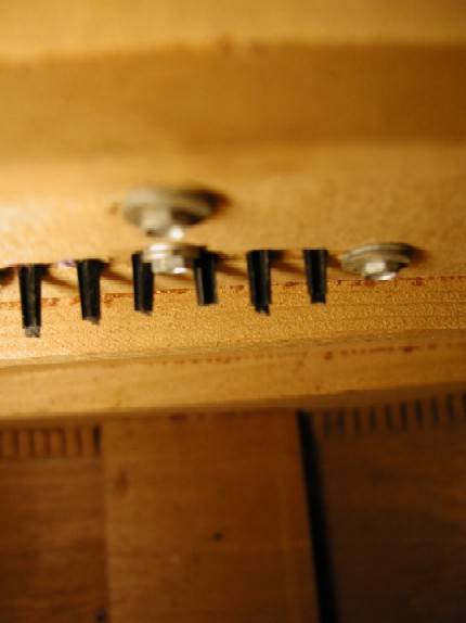

A client just brought in an old Gibson. Someone had re-attached the bridge with 5 woodscrews.    Not a pretty picture!!!    At least they attached it from inside the guitar.
The bridge is toast. I need to replace it. Before I make one, does anyone know a source for an ebony Gibson bridge that is belly up? It's the bridge that was turned around and the saddle slot looks like it is on the wrong side.

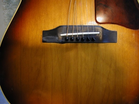

This is an Gibson LG-1. Here is a picture of the bridge. It is a plastic bridge. As you can see, it is starting to break. The owner loves this guitar and wants it fixed. An ebony bridge would be the most appropriate.
In addition, here is the picture of the screws holding it on. The picture is not the best but is as good as my camera would allow.

Hi Bob,
I forgot about the lamentable period from '62 -'68 when Gibson used these things. My suggestion is match the fingerboard. That is most consistant with Gibsons habits when they weren't using this method. The guitar you picture appears to be either an LG-(0/1/2) or B25 from the early sixties (it should be marked on the spruce back strip inside). The dark finish gave way to a cherry sunburst during '62-'63. A model of either of those from early 62 or earlier would have had a brazilian rosewood bridge.
--Mark Joy

PostPosted: Mon Jun 20, 2005 11:41 pm
Posts: 1542
You are correct I made alot of these of BRW to match the older gibson. I can make them out of ebony to. It amazes me they save about $3 if they used real wood and that plastic crap is horrid.
