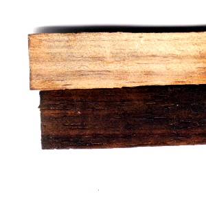

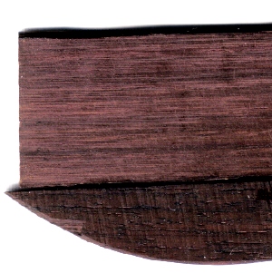

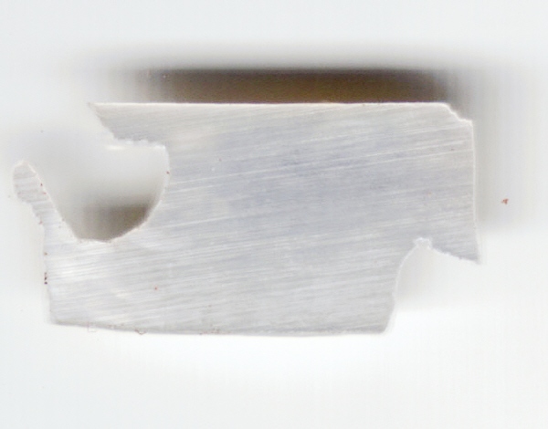

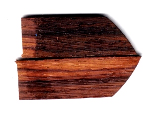

Ok here are the test results from this weekend. I painted one coat of the Clairol 116 black hair coloring mixed 50%color and 50% activator. I let it set 10 min. then wipped off, allowed to air dry and wiped with Naptha. Here are pics of the results
First is IRW
This is BRW
Koa just to see
Some scrap pearl. I let the pearl set in solution over night. no infiltration at all.
I did a second coat on the IRW and it got much darker. As you can see in the pic's , the greatest reaction was in the Koa. The least was in BRW. Oil content seems to have a nutralizing affect but not by much. So If you dont mind the smell It works very well
