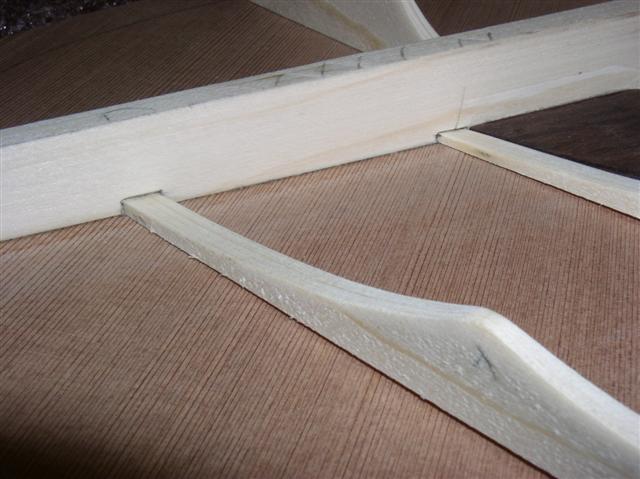

PostPosted: Fri May 06, 2005 12:15 pm
First name: R
Last Name: Coates
City: Selma
Sorry no dimensions I just go by feel but this one with an englemann top Sounded really good
Another view
Good luck

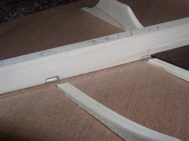

PostPosted: Fri May 06, 2005 11:13 pm
Ronn -
I see you dont tuck or butt your braces to the X brace, what are your thoughts on this practice? I always notch the X and tuck the brace ends in it.
LanceK38479.343912037
PostPosted: Fri May 06, 2005 11:29 pm
Lance - interesting. I've read about people doing it, but that's the first time I think I've actually seen it done. I don't, because I don't see the need to. Could you expand on the reasons you feel its necessary/good? I'd think not notching would free up that area just a little; on the two tops I've done to date, I've tapered the tone bars and finger braces down to almost nothing where they 'meet'the X-brace. Only the above-the-X braces (soundhole braces, including A-braces which are notched through the upper trasverse) butt firmly against the X, but again, no notching at the butt-joints.
PostPosted: Sat May 07, 2005 7:53 am
Posts: 1534
Location: Morral, OH
Lance:
I used to tuck all of mine but no longer do. Last 12 have not been tucked and there is a [noticeable] difference in tone ;)
tim...
PostPosted: Sat May 07, 2005 8:22 am
First name: R
Last Name: Coates
City: Selma
[QUOTE=LanceK] Ronn -
Actually this is only my second Steel string guitar. On the first I tucked the ends as you mention. I was pleased with the outcome but considered not tucking them on this one. I ended up not doing it only after reading the thoughts of more experienced builders in a thread on MIMF last year.
I can't give you a reason to or not to. I think the main reason for it is that the x brace is tucked under the linings and then this is tucked under the x brace. May provide some protection from popping a brace lose.
Truth be told, for me, I didn't see an advatage that would justify the extra work (even though it's really not that much).RCoates38479.7258680556
