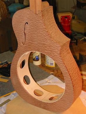

I have been building a Beard kit for my sponsored player Stephen Couch. This is a dobro style with a round neck. Im using some of the killer Sapele I got from Steve at Colonial.
I have swaped out the top,back, and sides, and have changed the neck from a simple but join to a M+T with better hardware.
I too have decided to use the 25.4 scale instead of the 25 scale that it comes with... I hope that is OK, and dosent mess up the tension or anything.
I was inspired by Dan`s pics a few week ago, and did a breedlove style cutaway on it.
Steven is really psyched to have the extra clearence to get all the up the board.
Matt

actually today I am looking at the neck set angle.
I`m not sure what to shoot for,
is a tall saddle desireable? or do I need to down close to brackett on the spider.
I am picking up that break angle is critcal to the tone of the instrument so I thought I`d ask around a bit.
thanks for any in put you can give me.
Matt

PostPosted: Wed May 04, 2005 12:32 pm

Matt,
Thats a nice looking resonator.
Would there be any issues to the size of the single F-hole being too small to allow enough air flow into the box for the cone to function at it's peak.
Daniel
PostPosted: Sat May 07, 2005 10:53 am
Posts: 556
Thats a good question, Thanks for asking it.
I had the same concerns actually,
My customer dosent like the round screens and asked me to use an f-hole instead.
Then I asked him if could add a sound port in the upper bout, and he didnt go for that either.
The good news is that he most often will be playing it on stage with a pick up installed. so I hope that will make up for the air volume loss.
I am also doing some unusual things to the finger board on this one per customer request.....its very cool.
thanks again for asking.
