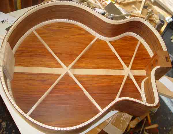

Thanks to some nice cocobolo I got from the Zootman a while back, I have been putting together this little fellow/fellowette...
I have switched over to the reversed kerfing and like it MUY better than the triangular stock I have been using up to now.

What a beauty Russ whats going on the top? I also LOVE The reverse stuff. For my last two I used the triangular stuff on top and Guitar Jigs Spanish Cedar Reversed for the back, Mmmmm the smell

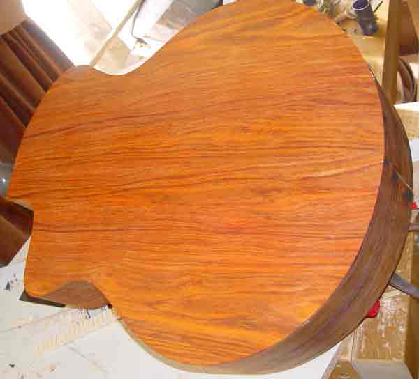

Looks great Russ. The back seam blends in so well it almost looks like a one piece back. Nice job.

Very nice Russ. I like the rounded lower bout and the reduced upper bout. Good looking. Clean work.

Lance,
This one is going to get an Austrian spruce top....very white and rings like a tele-marketer! :)
Thanks for the kind words everyone...I will put up some more pics when I get it buttoned up.
