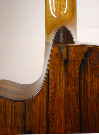

ok - I'm working on my first Cutaway, its not going to be squared off at the neck joint but rather, the body will conform to the heal of the neck -
Here is a picture of a Mark Blanchard guitar that shows what Id like to do.
Mark does amazing work! - What I'm worried about is making the neck block, what do I need to think about in advance? What are the pitfalls?
Thanks --
Lance

This is something you also see on the guitars of the de Jonge family. You can see some more pictures of this type of cutaway on the de Jonge Guitar company site www.dejongeguitars.com . This is going back almost 2 years but I remember a few of us who were taking the course discussing this method with Joshia de Jonge. I was also able to examine some guitars in progress that were getting this type of cutaway. From what I can tell you need to start by carving the same profile you will use in the heal into your head block minus the thickness of the sides (like Bob send). Next you bend the sides and glue them up. The tricky part is gluing the sides to the contoured block. I remember Joshia saying that you need (or maybe that should be might need) to fracture the side a bit to get it to glue to the block. This probably depends on how much to contour the heal. You glue any cracks you make up with CA when you are done. She said it is pretty easy (yea, for an expert like her I’m sure) to hide the cracks with dark woods but much harder with lighter woods like maple. Then I guess you need to carve the heal to match the block.
I have never done this before but am going to give it a try sometime. This is just how I think it is possible supposed to be done. Hope that is a little helpful.
Take a look at the concert classicals page on Joshia's site to see an example of one of her guitars with this feature. joshiadejonge.com

Thanks Josh, thats pretty much how I figured I had to do it. After bending this ziricote side, I did some flex testing and its very flexible, so I think it will conform to the heel quite well, with out to much convincing.

Joshia's cutaway - again - amazing work!
PostPosted: Tue Apr 05, 2005 4:54 am
I would reinforce the inside of that just below the neck block pretty good. That looks like it is just begging to split out. Especially on a wood that is known to split anyway like ziricote.

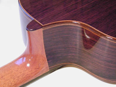

Lance,
It’s a lot simpler than it looks. Put it on paper first, full scale, like Bob said.
I also made up a mock up block with the contour and clamped it to a table with a profile of the side drawn on paper. I used a hot pipe to make the bend and keep checking it against the block and penciled outline. When it was close enough, I clamped it in place and left it to dry.
I didn’t have trouble with cracking. I don’t think it is putting any more stress on the wood than any other bend. But, then again, I wasn’t bending Ziricote either.
The only other thing I should mention is to make sure you are bending in the right direction or you will end up with a lefty. (Don’t ask how I know this)
Wade
Nashua, NH
http://www.wadefx.com

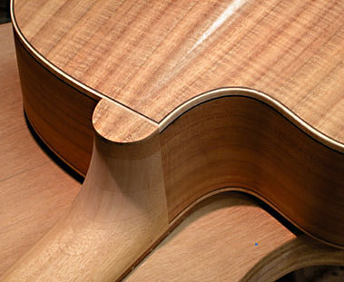

One of my early projects was based on an 1840's Martin, shown in
Washburn and Johnston's Martin book, with what amounts to a double,
tapered cutaway. Here's one shot of the joint --
I bent the twist by hand after the other bends were done in a Fox-style
bender. It's no more likely to split than any other part. (That may not
apply to Josiah de Jonge's complex shape.) The headblock was shaped on
the bandsaw and drum sander to get both the taper and recurves. The
mold is complex, allowing for different neck widths while supporting the
taper. Sides are attached with epoxy. Clamping was a nightmare,
requiring clamping the entire mold to a rigid form that also located the
headblock. The neck is set with a mortise-and-tenon.
One thing that no one has mentioned is that the sides have to be wider at
the head due to the twist. The edge that contacts the back of the guitar
will have a slight flare.
Have fun! It's good hand-bending practice.

Wade, I just noticed you used a matching piece of your back for the heel cap, I see the grain lines match - VERY nice and good thinking ahead....
