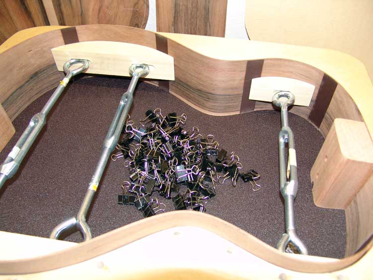

i was just contemplating spending some money on some clamps dedicated to the glue up of kerfed liners. ive seen everything from clothes pins to... you name it. i know just about anything will work, but in your experience, what has worked best for you? obviously, cost is an issue, but so is performance. i was thinking about these:
http://www.hobbytool.com/index.asp?PageAction=VIEWPROD&P rodID=9
pretty cheap for a whole bunch of them. i was checking out what i believe are the same clamps at home depot. it seemed like there was a decent amount of clamping force, but then ive never glued any liners up, so im not sure how much force is required. any thoughts?
sweat the small stuff.

Welcome, Aasmund, to the OLF. I haven't done it yet, but I bought a bunch of Gem Clips, like Hesh, and lined them with self stick cork bought at a craft shop.  1 piece lined about 40 clips.  I also have some old clothes pins that I could use in tight places, since they aren't as wide as the clips.

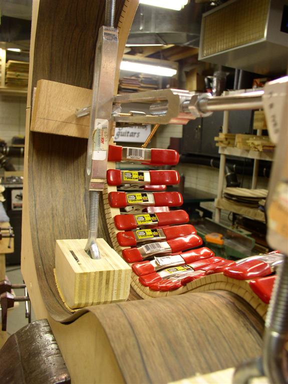

I've done well with the 1" spring clamps from Grizzly, with a few smaller clamps for odd spots. I've also found that in the waist or cutaway it's hard to get enough clamps in; in those spots I use a big spring clamp from the other side, with a stick of wood to transfer the pressure to the liner.
I have a bunch of the style Steve S shows, but found them too weak.
