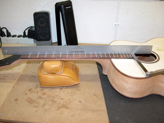

OK Mario I just had an "ah ha" moment after reading your last post which clicked with me.
Are you saying that you plane/sand/lancelot in the drop off on your fret board prior to fretting them off the neck?  This is what I am unsure of in what I am reading here.
I too go for about a .015 drop off at the 21st and perfectly level frets for 1-14 and this is of course not under string tension.  The best that I am able to do so far toward this goal is sanding the board on the neck, level between 1 and 14.  If my upper bout does not provide the gradual drop off between 14 and 21 I sand that in with a radiused beam.  And of course the frets between 14 and 21 in such close proximity will create the most amount of back bow in this location too.
Here are some pics of what is on my bench right now.  Although it is difficult to see with my pictures I have a dead level board and frets between 1 - 14 and a gradual drop off, which I agree is advantageous, between 14 and 21 resulting in a .016 final drop off at the 21st.
I have been doing this drop off for a while now for the exact reasons that you indicated.  I just can never predict if my upper bout will be perfect or if I have to sand in the drop off on the fret board manually.
BTW the frets are leveled and recrowned but not cleaned up yet......
