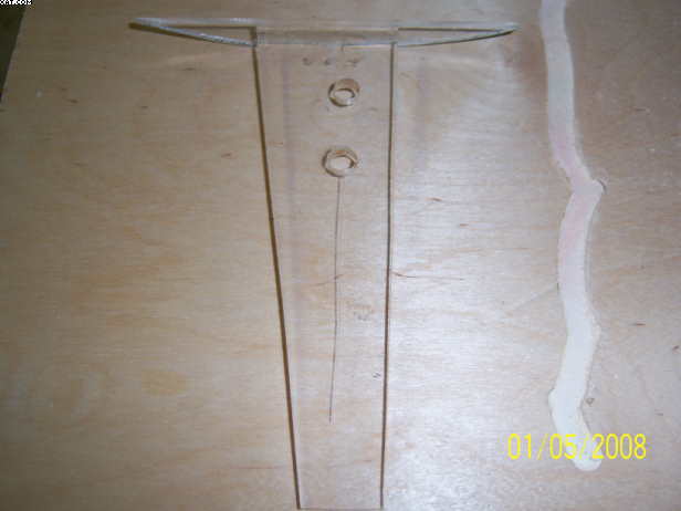

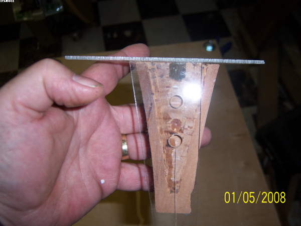

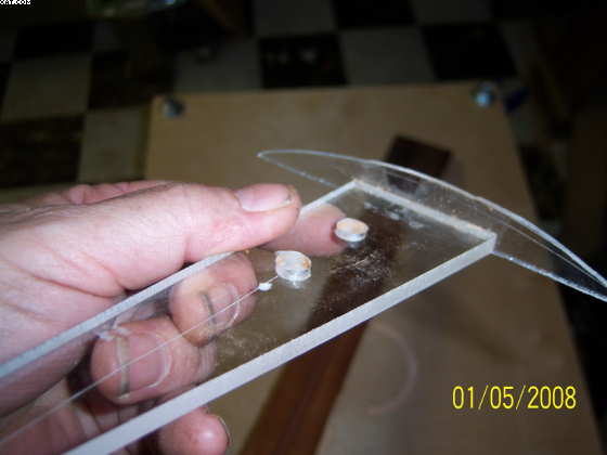

Someone asked me a while back about how I went about lining up the holes so that the bolt lined up with the insert. It is as simple as making yourself a simple T-square, complete with a center line and the holes pre-drilled in the jig. I think the pictures are self explanitory. I made this out of some scrap pieces of lexan and it works perfectly every time as long as you keep the center lines lined up.
 WHile these pictures just show the neck, you can reverse it and drill the holes for the body of the guitar with the same jig. It is one of the last things I do before I set the neck.

That's great, Ken. Thanks for posting the images! How do you hold the
neck to make sure the holes are squared?
PostPosted: Fri Jan 04, 2008 6:10 pm
I usually hold the neck in a soft jawed vise when drilling it. Getting it square isnt the real problem..... drilling deep enough to accomodate the insert without driliing completely through the heel is the real challenge

Ken, This idea is good, but consider the following. The plexi isn't thick enough to ensure square drilling with a hand held drill. Also, the plexi will wear out. Make the plexi at least 1/2" thick. Using a drill press, drill holes and insert proper drill bushings into the jig. This will enable square drilling and jig longevity

I agree with you about the inserts if you are using a jig like Kens. Mario has a great picture of this on his website.
