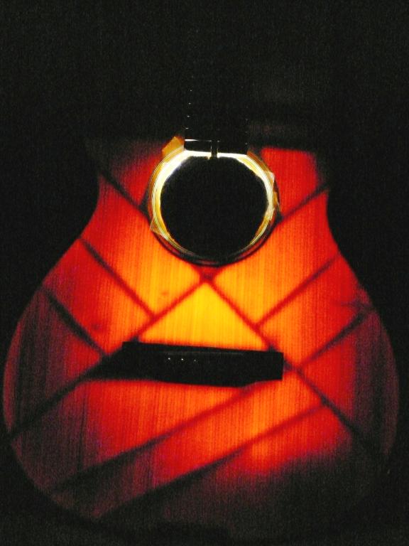

Hello all,
I'm considering copying Martin's Norman Blake 00028 model for a first
guitar. Yes, probably setting myself up to lose some hair, but maybe I'll
come to my senses -- if I can remember where I left them.
Anywho -- the uniques features of this model are a 12 fret to body neck
on a 00014 fret body. This moves the bridge lower on the lower bout.
Sound hole is 00 size, and is positioned approx. on center with apex of
waist. Soooo, the things that are happening on the surface of the
instrument aren't too hard to get measurements on; the trick is the top
bracing. According to Martin's description, the pattern is unique to this
model.
Does anyone have any specific info on this model's bracing?

I think the main difference with the NB bracing is that it is forward shifted as in the pic below. Note the bridge just kisses the X brace. If you are determined do this bracing pattern make sure you get hold of some STIFF spruce.
(I got this from the UMGF forum and don't know whether it's copyrighted or public domain so feel free to delete this Lance if it contravenes the Geneva Convention)
There is quite a library at the UMGF of Martin bracing patterns but impossible to link to the page where it lives thus I posted this here. It's well worth a look though.
The NB also has a 19 fret fingerboard.
Bob

Thanks very much!
Thanks, too, for the heads up on the 19 fret FB. This must allow a little
less downward shift in the soundhole placement.
I had read that the braces were shifted forward, and thought that was
intereesting given that the bridge is already lower on the lower bout. I
don't know the standard angle at the x for Martin 000/0M, but this one
looks darn close to 90 degrees -- which looks to be critical (in this
arrangement) to getting some bridge postion overlap with the braces.
Martin also used the 00 soundhole size (2-7/8" ?). I wonder if this
decision was driven by the x brace design/bridge placement, or other
reason?
Thanks again -- super helpful.
C

    I can tell you that I have the actual bracing patten for this model. As far as the top bracing and sound hale are concerned it is nothing like the 000 or 0M. It is in a sense its own design totally.
     I can tell you that the bracing is scale oriented and 24.9 .

I just finally read the Martin specs and voila! All is revealed!   The answer is...."Unique Top Bracing Pattern"!
A couple of things...the small sound hole is going to drop the Helmholz, and forward shifting the braces like that and having so little bridge directly over braces is going to make this a boomer.   It looks to me as though Norman wants to get the rumble of his old 12 fret long dread bodied guitars out of a smaller instrument that's more comfortable to play.
