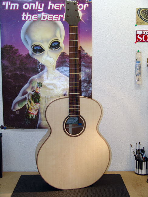

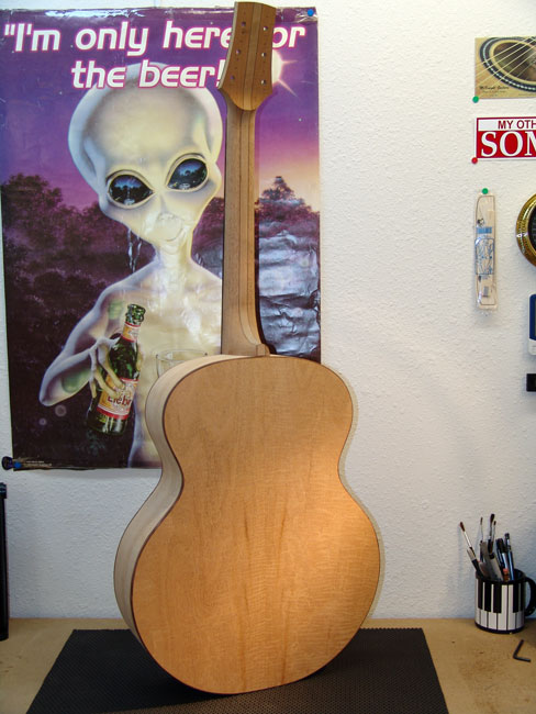

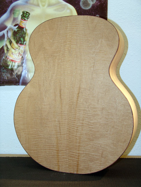

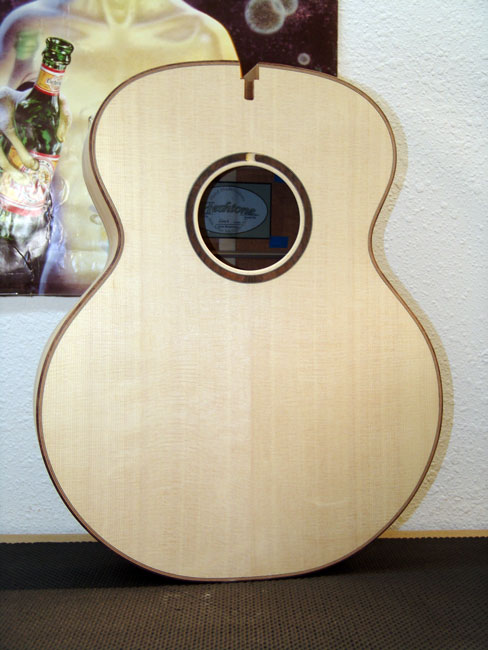

I just finished the final sanding of the box for #15 and I am pretty excited with the results.  This one is going out for finishing next week and getting a poly finish from Joe White.
Other then installing the heal cap and final sanding the neck it is ready to go.
The top is some of Shane's outstanding Lutz which has some bear claw in it.  The back and sides are Honduran mahogany from Uncle Bob.  The fret board blank and bridge blank (both BRW) came from Steve at Colonial.  And the neck is from John Watkins mahogany/maple/mahogany.

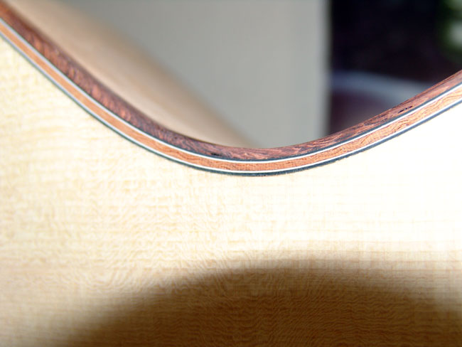

The purfs are something that was new for me and I first saw these on a HGF guitar that Brock exhibited.  These are also from Uncle Bob and Mahog-O-Lam which I think came out very well.
I thought that I would share some pics with my OLF pals.

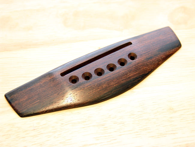

First check out this BRW bridge.

Hesh it looks great.   I am really impressed with the elegant and simple design of your bridge.

Looks mighty fine as usual Hesh. I like that purfling on the top from Zootman.It looks very nice!

Very sweet, Hesh!  Love that purfling...nice touch!

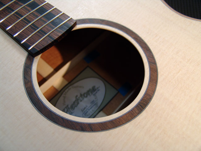

Beautiful Hesh!  How 'bout a closeup of the rosette! Is that BRW?

John my friend thanks for the kind comments on my bridge.  There were three inspirations for this design which I call the "Stealth" bridge.  First was Scott Van Linge and the info that he shared with us a few years ago.  Second was the flying wing, BII bomber, and the third inspiration was a melting Hershey kiss in the middle of a cookie just out of the oven.......

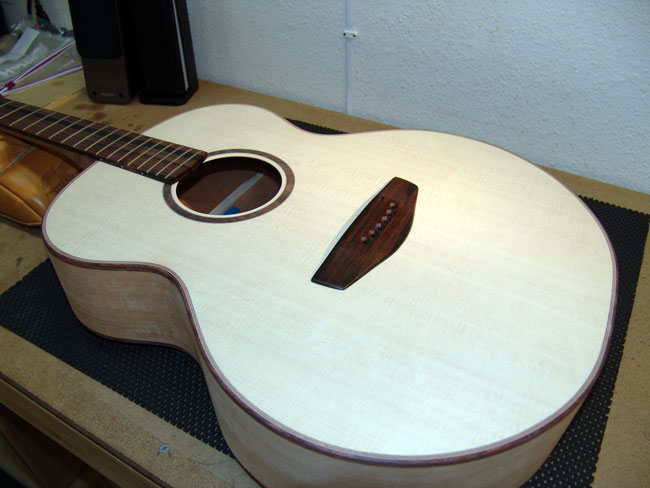

JR here is a not so good shot of the BRW rosette.

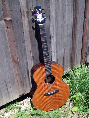

Andy bro this is my 3rd SJ but the first one in a couple of years and the first one that I parabolically braced.  Here are the other two.

Great looking guitar. I especially like the purfling on the top. I am going to have to try something like that. Can't wait to see it with finish on it.

did you hand bend the purfling or did you make an undersized mold? Love the purfling
PostPosted: Fri Jan 04, 2008 1:38 am
Posts: 13707
Michael the purfing was a dream to work with.  I just thicknessed it in the Performax to around .060 and taped 2 pieces together and bent it in the Fox bender on the same form as the sides.
The purfing is flexible to a degree and it pressed nicely into place with no gaps.  Very easy and a nice alternative for something different, not shell, and all wood.  It comes in maple too.
