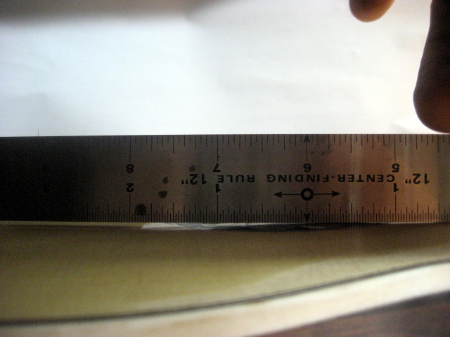

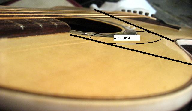

PostPosted: Sun Jan 06, 2008 10:50 am
As promised, here are some pictures to show the problem. Pretty difficult to capture and hope this helps.
Drew in a couple lines that show approx location of x brace and sound hold brace. What is caving in slightly is the are in the middle.
The above shot shows a straight edge sitting on top of the x brace and going to the fret boad area of the soundboard just north of the soundhole.
Also, the xbrace is showing the outline on the soundboard just where the problem starts (not the entire length of the brace)

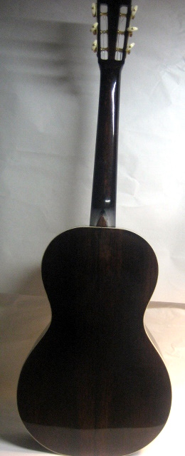

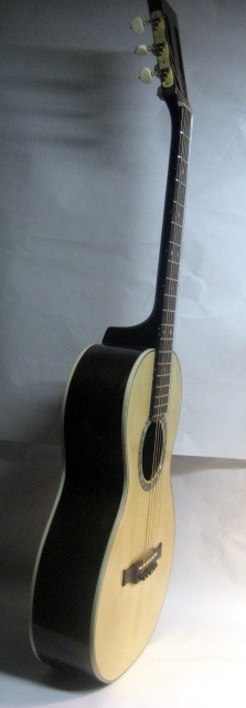

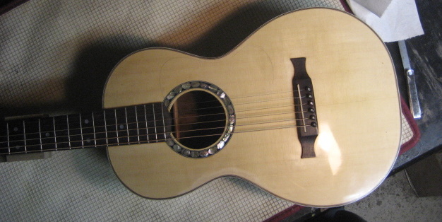

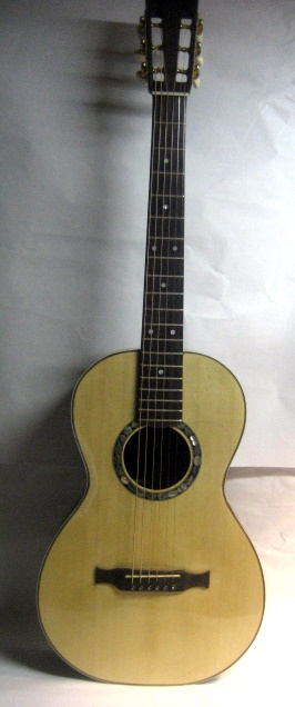

FOllowing are some pictures of the guitar which is Brazilian back and sides with I think an adi top but cant remember. It's in the middle of some repairs to some binding that came loose and applying some additional french polish were it got scuffed up from bring on the road with me.

Not the first place a top would cave in, isn't it?  Odd.
How is the connection because upper transverse and sides. Was the bar of good spruce?  Is there any distorsion on the side or on the back.  Wondering if the neck might be creeping up.
With a steel string guitar, the neck first wants to creep out of it's joint. If it can't move from there, then it pulls on the box...primitive thinking but it seems that is what happens. (my impression from the dovetail neck classicals fitted with steel strings we use around here as campfire beaters)
Build log
PostPosted: Sun Jan 06, 2008 12:17 pm
Alex, I suspect you are right. There is no movemen of the sides or back and it looks to me like the fretboard pressure is more than the soundboard can handle. The soundboard in the area most effected seems very thin. Perhaps I thineed it too much when finish sanding. I dont think the braces are failing from what I can see.
Also, just a correction, I said this was Englemen in the early posts and then in error said it was Adi. It is definately Englewood so it might be too thin for Englewood.
I might try putting a Spruce path in the area, kind of double the soundboard just between the traverse brace and x brace. Dont think it will impact the sound all that much and if that fails I will make a new top.

Ironically, a couple days ago a friend brought in his cheapo steel parlor with a serious neck disjoint, theres already more than 1mm of gap and the action rocketed.
I just put a straight on it and the cave-in is huge. Ladder braced. The lower bout looks just fine though. Insanely overbraced as well.

Very nice little guitar.
This is a 13 fret to the body. Was that the original plan or did you adjust the bracing accordingly?
PostPosted: Sun Jan 06, 2008 10:10 pm
The 13 frets to body was part of the original plans.

That doesn't look bad enough to warrant replacement, for sure. Just keep a eye on it, ad it it continues further, come back ad ask again. For now, get the feeler gauges out, and measure the dip(straight edge, feeler gauge), ad record it. Check again in 6 months, then a year, etc... It should stop at some point(wood can only move so much before it takes its set). Only if it doesn't ever stop moving should yo interfere.
