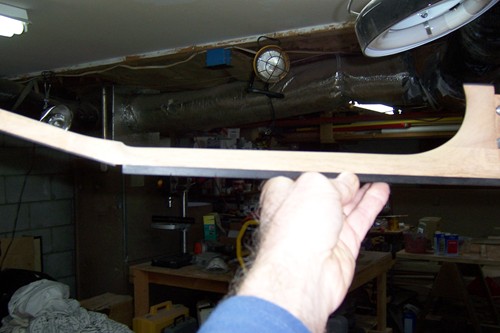

I use the inflatable Grizzly drum sanders on a hand drill to shape the heel.  Then rasps, and scrapers and sandpaper to fine tune.
I use a trick Charles Fox taught us for the shaft.  Shape the exact profile at the 1st and 10th frets (for a 14 fret) using, rasps, sandpaper sticks etc. until your templates fit perfectly.  Hog off most of the excess wood in between with whatever you like.  (I'm using 40G on an air sander right now.)  Then get a flat piece of 3/4" particle board cut to the same length as the distance between the 1st and 10th frets with the edges rounded a little.  Cover it with 80G self adhesive paper and put a 1" strip of the brown StewMac binding tape on each end so it rides on the profiled areas.  Sand horizontally with this and it will blend the shaft with the previously profiled areas and come out really flat.  You can then finish the transition from the heel to the 10th fret with the drum sanders on a drill and the usual array of tools to get the final product.
I'm sure the more experienced guys just whip the whole thing out freehand on a belt sander in 15" but this is pretty foolproof for beginners like me.
I do have a little template for the heel profile that works great with a RoboSander.  This should get you there I hope.
http://kennedyguitars.com/Kennedy%20Guitars/Heel%20Profile.h tml
Terry

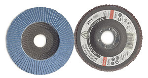

Or, if you have access to a 4" grinder but the Lancelot is too intimidating, these things do a killer job at stock removal and can leave a pretty slick finish. It does still require a light touch. You will be surprised at how quick you can remove stock with a 36 grit disc! Pop it off and put on a higher grit and they can slick off pretty well, too.
Other than that, I have two 4" belt sanders - one with 40 grit and one with 80. I hog off the majority of the stock around the heel with one then swap right over to the other without missing a beat.
Wes McMillian
Santo, TX
http://www.wesmcmillian.com

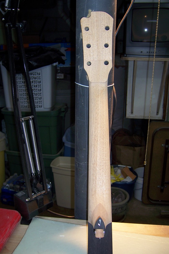

I`m thinking you wanted some pics of some necks. Okay just kidding. Here`s what I like.Not what you can get from a bought pre carved,but it appeals to me.
This is one of the most rewarding parts of building a guitar for me.Check out Robbie O`Briens video available from LMI,It really explains neck carving in a way that is easy to understand.I use a spokeshave and a # 49 Nicholson Rasp, and then sand as in Robbie`s video.Hope this helps.
                        James W B
