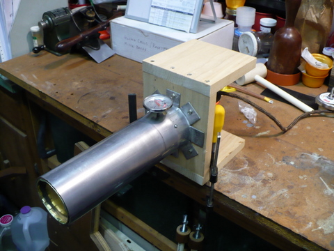

There is always more than one way to skin a cat.  My pipe bender cost me about $10 - 20.00.  Truck tail pipe section [24"] (sawed in just under half and the second piece slotted with a hacksaw, then squeezed into the other half to give it more mass.  Heated with an old 5 watt Soldering Iron. I packed some miscellaneous pieces of steel around the iron to transfer the heat to the pipe.  Just pieces of flat bar stock cut with a hacksaw.  You could fill it with old screws.  It wouldn't matter.  Other heating elements that work well are BBQ fire starters, bent to fit in the pipe, Propane torches, as Grumpy mentioned, a heat gun pointed into the pipe, be careful to close the end near you (probably the same with a torch).  Mine looks like this:
The thermometer is a BBQ grill thermometer.  $5.00 at Home Depot.
