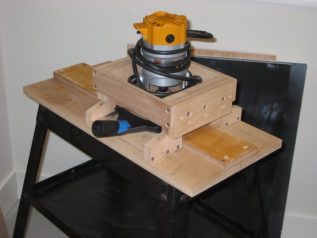

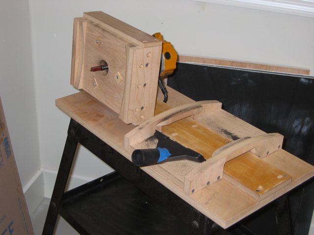

I built the router jig based on the Micheletti plans. Check here I have found the jig to be fast, accurate and simple to use.
On the slotting side I use the fine tablesaw blade provided by Shane and built a simple sled to cut the slots.

HERE is a supplementary to JJ thread on Rick Micheletti's jig. I have done a few boards with mine now and found it to be excellent for any number of various radii. It is fast, easy to use and simple set up. But like any jig, take your time when putting it together as it will only ever be as accurate as it's construction, build in an error and it will transfer to your workpiece, every time.

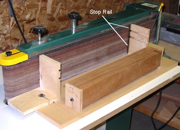

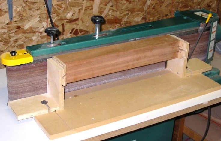

Posts: 1271
This works for simple or compound radii.
The fretboard mounts to the piece in the foreground with double stick tape (vacuum would work better). On each end is a pattern (same radius or different). The bolt that holds the pattern on rides in one of the slots on the jig. Having more than one slot allows you to use more of the sanding belt. The patterns then contact a stop rail that sits right next to the belt.
This is how it looks in use.
If you don't have an edge sander, this same concept can be made to work on a jointer.

[QUOTE=Kent Chasson]This works for simple or compound radii.[/QUOTE]
Kent, if that's all that meets the eye there, I don't think this will
quite work for a standard compound if you simply put a different radius
pattern on each end and have the end-bolts aligned on a single axis. I
tried this, and while maybe close enough, it is not a true compound.
Think of a regular compound radius (where the radius changes linearly
with length) as a section from the outer surface of a cone; the
patterns at each end then cannot have a radius center located on an
axis parallel to the fretboard surface.  With a cone, the outer
surface is at an angle to the rotation axis, and the angle changes with
the aspect ratio of the cone.
So for a compound, your fretboard mount would need a different bolt position (at one end) for each different radius.

Erik, to be honest, I'm not sure if this gives me a geometrically perfect compound or not.
For what it's worth, I'm not even shooting for a conical section. I started with the radius I wanted at the nut end and determined the radius that I thought would work best at the other end by working backwards from the curve of my saddles.
A conical section makes sense on paper but in reality, given relief and the fact that the strings tend to need progressively higher action from 1st to 6th, mathematically perfect geometry breaks down.
This jig does give me the radii I want at either end with a smooth transition between. And it gives me what I'm really after which is a linear surface under each string path, or at least something pretty darn close that has proven to be a better starting point than a cylindrical board.
And it was really easy to make, easy and quick to use, and easy to change if needed.

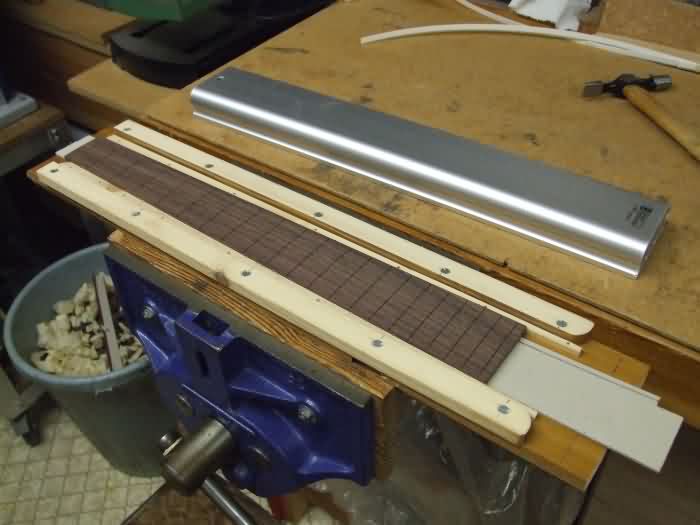

Al Peebels showed a fretboard radius jig he designed and built in May 2006. Here's a pic from the archives
Serge built one and used it for a couple of boards with good success, and he was so nice as to make me one and send it to me. I haven't used it yet but am looking forward to using it. It really looks simple to make and use.
PostPosted: Sun Dec 30, 2007 3:41 pm
I wanted to add that in the thread linked in my first post, there are links to plans for the jig which Al has made available to anyone who wants them.

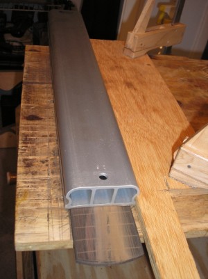

Elbow grease here! Love the Stew-Mac radius caul :

Same here Dave. The StewMac aluminium block really gives a perfectly flat end to end finger board. I have the 12 and 16" versions. If I built more instruments than one at a time, I would mechanise this process.
