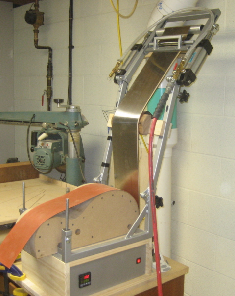

Bender is heated to 280-300 degress AND then the wood is loaded into the bender. I only want to heat the wood when I am bending to not dry it out.

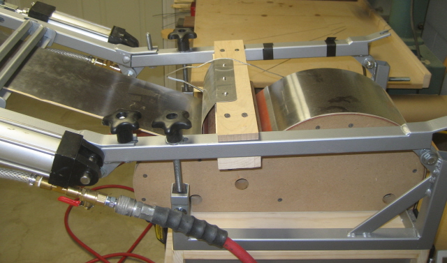

At this point I support the upper arm of the bender, hook the lower slat with the upper slat and apply 40 psi to the air cylinders to pull the slats in tension.
I bend the upper arm back which creates about 75% of the waist bend.
Keep in mind that I have a 5 x 6 heating blanket at the waist caul to just heat the waist.

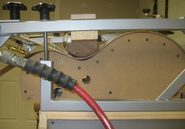

Bending the lower bout.
I now tighten two clamp knobs that brings the waist in tight with the form.

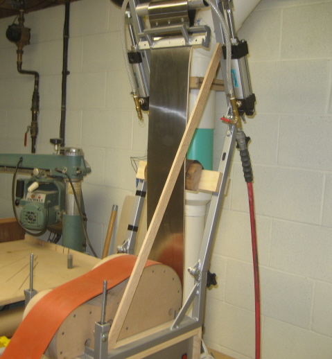

Bird's eye view. Ready to bend the upper bout.
Bend the upper bout.
