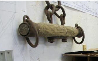

1. Do you use the singletree?

Bruce, is this the singletree?
If so, it was something my mother-in-law bought for my wife. It was for decorating in the rustic country style. None of us even know what the thing is or what it's for
