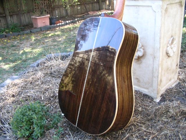

Mike - Kim pretty well summed up how I use it.
Straight from the bottle it's a 4lb cut so it will need thinning if you are going to french polish with it.
I'm happy enough with it. Here's some pics.
Bob

PostPosted: Mon Dec 31, 2007 12:37 pm
Posts: 698
G'day Jeff
I'm just finishing a 12 string out of Blackwood.
Pore filled with Z-Poxy finishing resin then sanded back so the resin only remains in the pores.
2 coats of Hard Shellac straight from the bottle about 15 minutes apart.
Hang it for a month to allow the Shellac to cross-link.
Sand with ROS 400 grit to level.
I then sand with ROS micromesh 1000 and 2000 grit (Festool platin2)
Then off to the buffer with fine Menzerna compound.
Bob
Bob Connor
Geelong, Australia
