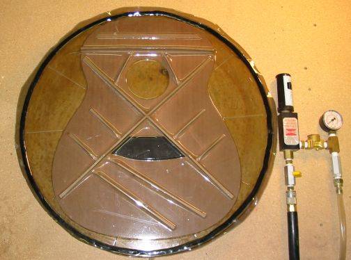

This is an easy solution if you don't want to go with a frame. I glued a sheet of 1/8" acrylic with contact cement to my dish, cut some air channels, glued in a barbed hose fitting. I seal the vinyl sheet down with butyl tape. The tape lasts for several gluings but needs to be replaced after a day or two as it wants to become permanent.
As Bob said, the vinyl is not as flexible as the rubber but the thinner stuff works fin...and you can see!
I made this set-up when I was using a venturi and wanted a totally airtight system so the compressor wouldn't run all the time.

That is a nice setup, Kent. Cheap and effective.
