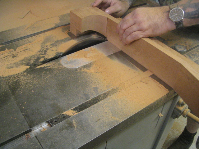

[QUOTE=Rod True]
The back side of the neck is curved as well as the transition from the heel to the neck shaft [/QUOTE]
But with a little imagination most anything is possible on a tablesaw:
These shots where taken in none other than William Cumpiano's shop with Dave Alex at the saw. I believe the recipe is 7 1/4" blade for a classical contour and a 10" blade for a steel string. Fine if you wish to go that way but a good sharp chisel can hog off a lot of wood quicker and probably a little safer also.
PostPosted: Fri Dec 28, 2007 8:49 pm
Oh, best add that the above method can be quite dangerous, you are using the blade of a table-saw as a shaper. Therefore you are in fact feeding the material across the blade and not into the blade as designed.
If you wish to have a go at this you will need to make sure that your saw is not under powered and that you only touch feed about 1/16" at a time. Steady, steady will keep the stuff that is not meant to be cut where it belongs.
