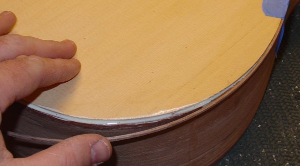

If you are thinking about making your own purf, check out this tool before spending the big bucks on the LN.
I used this wood strip cutter from MicroMark, on my current build. It took a little practice to get it right. As any slicer would, it really wanted to follow the grain. Many light cuts is the key to getting a nice slice. I didn't get any photos using the slicer, but here is the result.
