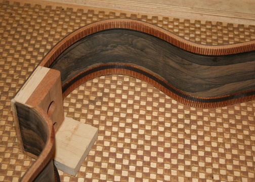

Modified Reverse Kerf Linings

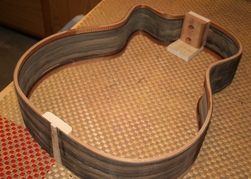

Here's the Ryan A4 kerfing on one of my guitars. Very thin kerf that would be almost impossible to do without a laser cutter....

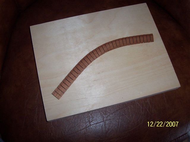

I'm wondering if we are making this too complicated. A simple mod to regular kerfed lining (Kerfing ) allows it to bend as shown.
Nelson

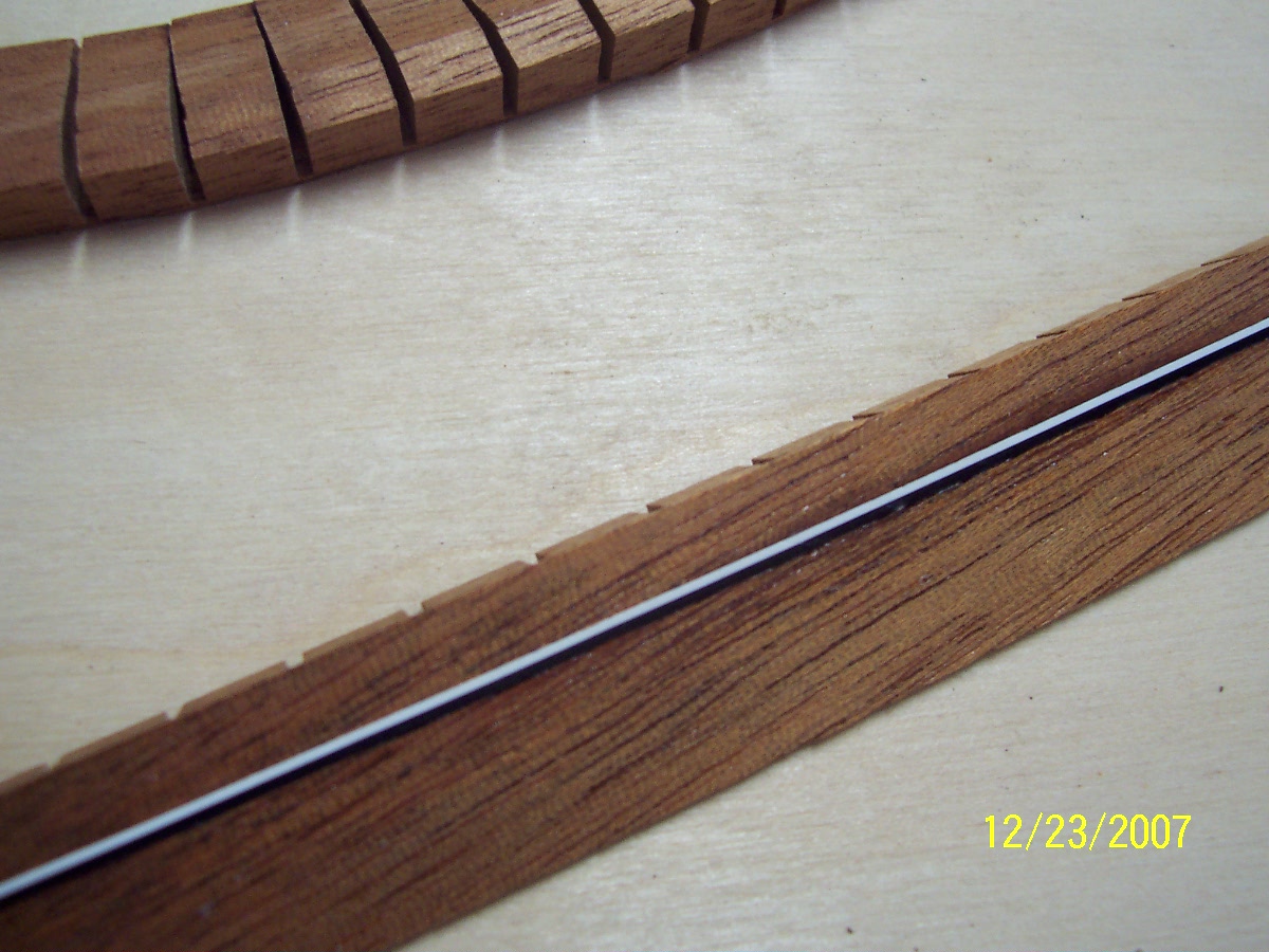

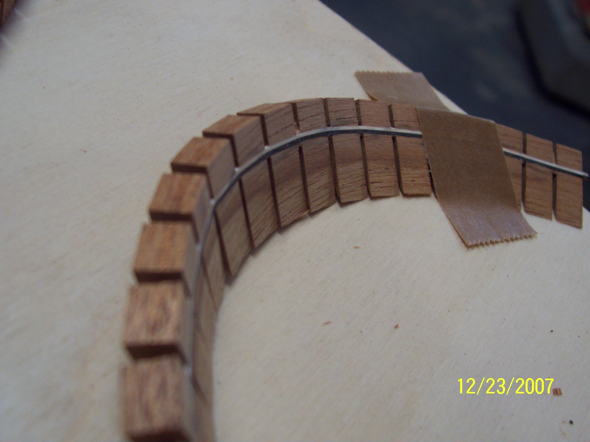

Back to your original question, this may be a way to accomplish what you're wanting. It's simply a piece of plastic binding embedded into the strip to let it flex in all directions.
Nelson
