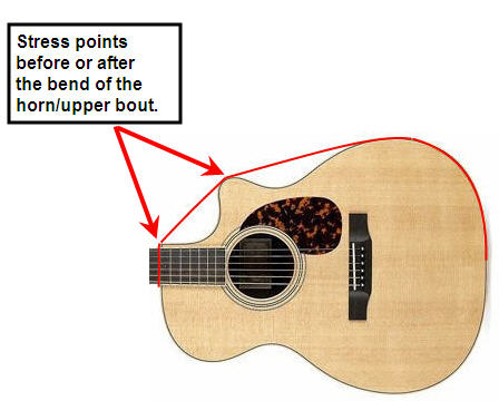

James, just for the cutaway is all. Pulling the upper bout than the waist in the cutaway bending form, I would think you'd have a lot of stress on the horn of the cutaway when bending the waist.
I bend on my Doolin style bender, just how Mike describes and does, so again, I'm just saying be careful to bend the upper bout on the cutaway after the waist is bent.
I'm not saying it WON'T work bending the horn after the lower bout, I'm just saying be careful.
Take a look at this, maybe it will help
See with out the cutaway it's all a smooth bend and as you lower the waist, the side bears down on a smooth (and fully supported on a solid mold) curve where as if you bend the cutaway first, look at all the points the side will be stressed over not to mention the tight bend of the cutaway itself.
For the cutaway side, I think it would be difficult to bend a venetian on a Doolin style bender.
I know Rick Turner uses the same style bender and back in July he mentioned that they just bend the cutaway on the pipe instead of in the bending machine.
I certainly could be wrong (it's happened many times before) so please, someone give it a try and let us all know how it turns out, good or bad we all will learn from it.

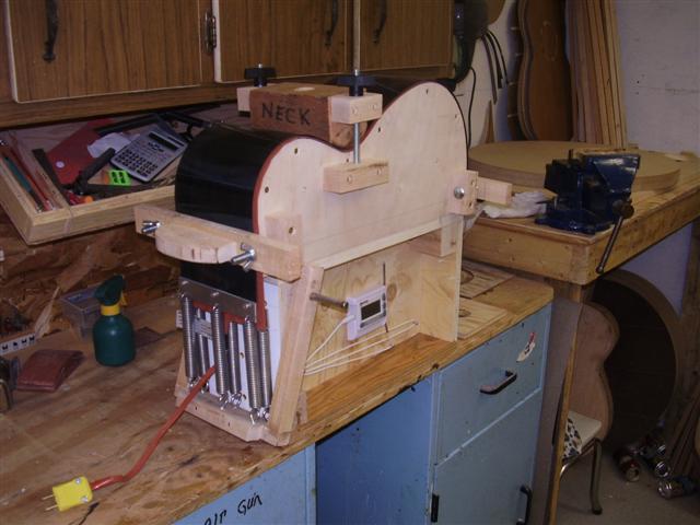

That certainly sounds like it would work Mike. Except for the fact that you'd have to pull the side out (I think) to remove the "removable piece" than put the side and sandwich back in. Maybe you wouldn't though, if the piece could be pulled out from the side. Than the springs will make the sandwich (and cool side) bare down on the sharper points as shown above.
Check out this picture of the head end of the machine,
the spring arm pulls the sandwich down (there's a lot of tension on those springs when the waist is clamped) if you were to add a venetian cutaway to the mold, the spring arm would have to be rotated 90* upward to ensure you don't kink the side or slats on the front edge of the body.

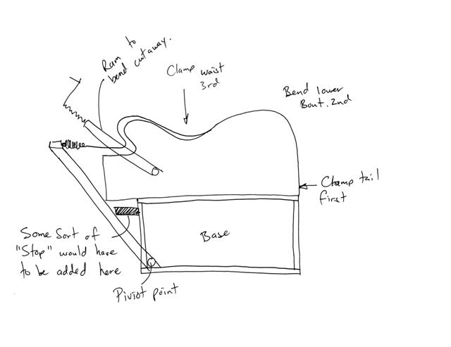

Ok, take a look at this, I think it could work.
What do you think?
PostPosted: Sat Dec 22, 2007 4:12 pm
The "Stop" would have to be adjustable I think, so that the slats would remain taut the entire bend.

PostPosted: Sat Dec 22, 2007 4:29 pm
Posts: 1018
Location: Denver, Colorado
Ok, I see. Looks like it would work great to me.
This would be a separate pivot arm from the one used for non-cutaways, correct?
PostPosted: Sat Dec 22, 2007 4:32 pm
The other thing you could do to make this work is to add a pivot point at the top of the spring arm where the springs are attached.

You got it Mike, I think you'd need different springs too.

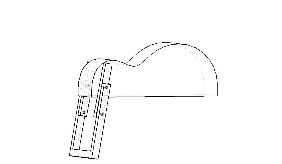

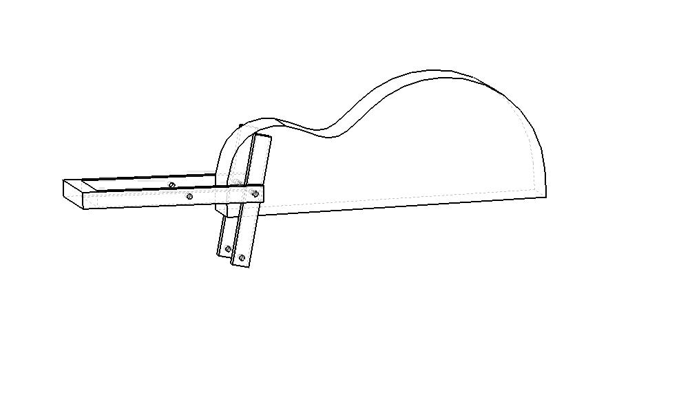

Posts: 744
Mike and Rod...
Here is a concept I have been kicking around. The drawings are missing some details but I think you will get the idea.
Bending upper bout
Bending the cutaway
I am just about to finish a bender that uses a few pnumatic cyclinders rather than springs. This allows for more force but what I noticed when testing is that if the force from the springs/cylinder is pulling inline with the arms then it takes much less effort to make everything work. It will also minimize the movement of the springs.
Brad
