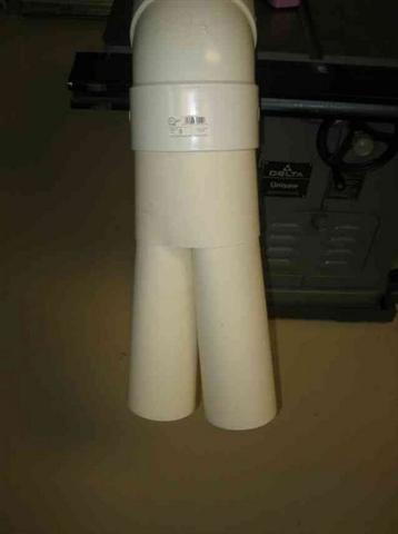

Danny, here is a picture from a user. I think we are forced to use 4 and 2 inch connectors at the machines, because that is what they are manufactured with.
The issue is entraining the most dangerous particles, it takes a lot of velocity. 6 inch pipe, 3 HP motor, few turns in the pipe, no restrictions.
One of the guys showing his shop devised a simple six by four four wye. Here is a pic:
He puts blast gates at all these six inch drops. I'm wondering where to get six inch blast gates? Also, I wonder how he sealed off the 4 inch pipes? I see an attaching screw to the 6 inch.

Bruce, that home built "y" looks like it could be made to work. Here in
