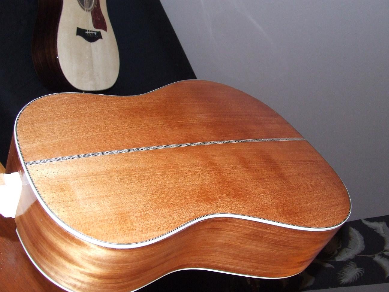

Hi all, I just did pore filling on these two guitars, and have some problems with dark areas.
The process have been:
one thick coat to start with, then sanding back to wood except where there was uneven levels in the wood, leaving areas (islands) of epoxy. Then another coat to fill the last few pores.
I then put a washcoat of zpoxy-alcohol(70-30) to even out the color, something ive read on this forum its possible to do. But the 'islands' of zpoxy are still very evidently darker in color. Is this something I will have to live with?

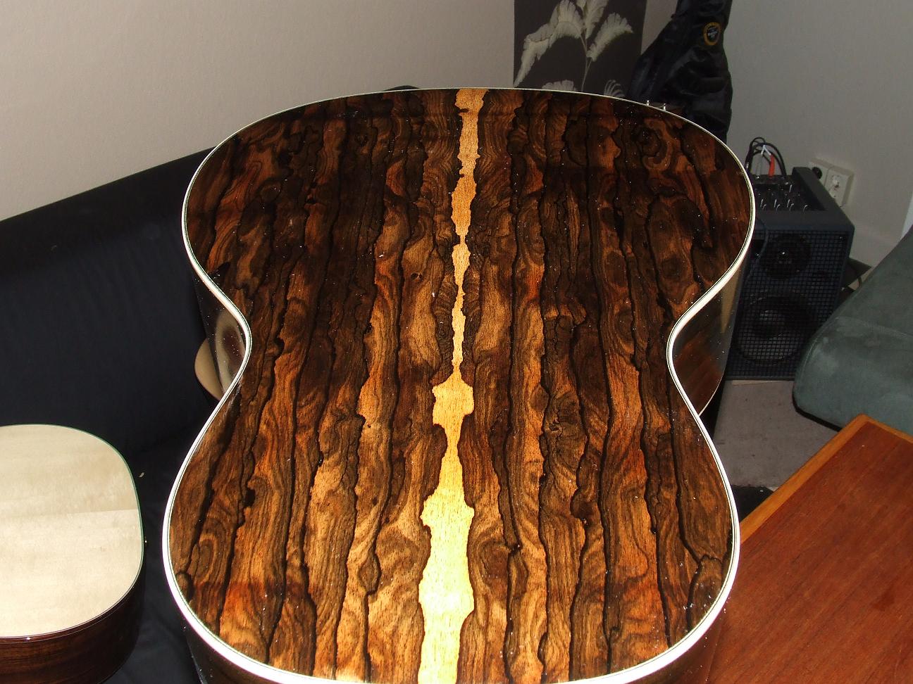

Less evident on the ziricote guitar, but you still see some.
Have I understood the trick wrong? I have used zpoxy on two prior instruments, both very dark brw, so this problem havnt been visible before.
Well, just I thought Id throw out the question.

Lars my friend there are two schools of thought on using epoxy finishing resins to pore fill:  One is to sand back to the wood leaving it only in the pores.  The other is to leave a very thin film on the entire surface of the wood.
For people who leave a thin film on, like me, the wash coat of 50/50 is applied to help even out the color where we may have sanded through but the wash coat is evenly applied to the entire areas that we pored filled.
From your very good description of your methodology it sounds like you used parts of both methods, sanding back leaving it only in the pores in some places and leaving "islands" of epoxy film in other areas.  Hence, IMHO the darker spots.
What I would do is either method but if sanding back to leave it only in the pore do exactly that, no islands and no wash coat.
If I was leaving a thin film I would likewise endeavor to have the film on the entire guitar (not the top) and then use the 50/50 wash coat.
The root cause and why you left some islands here may be that the wood is not very level in these spots.  Perhaps more level sanding prior to pore filling is advisable?

I do not like to see the initial pore fill leave much film thickness at all. One every filling session I scrap off all excess epoxy as much as humanly possible. i want epoxy only in the pores. Now that is really impossible as the surface tension of the epoxy will cause you to leave at least a very minor film on the wood.
If you build a heavy film then level out you are likely to not truly level parallel to the woods surface. this means as you sand back the film will smooth out with some areas deeper than others which will mean you will reach wood in some areas and still have a dense film in others and end up with what has happened.
Also a 70/30 cut of epoxy is so thin that it is not likely to equal the the thickness of the islands you left. 60/40 or 50/50 would have been better
Now for the good news. I am assuming that you have not seal coated the guitars as of yet. This disparity may very well disappear or at least be toned down with a couple seal coats of 2# shellac Or you could even make up a 50/50 cut of epoxy "first"(as in prior to any shellac!!!!!!!!!) and make an other rag on application. avoiding build up at the islands and then lightly level again.

Thanks for your input everybody. Seems like its sanding back to wood thats the cure for my problem... Well, I have only used the zpoxy on very dark woods(brw) earlier so this havnt been such an evident problem yet, but now it all makes sense to me. The cut I used for wash coat was 70 epoxy/30 alceehol, sorry if i was unclear on that point.
Ok, Ill sand back, and do a 50/50 wash coat. Man this forum is great!

This is not helpful to you, but I LOVE that Ziricote. Is there a sister set to that? Been looking for that for a few years now.
