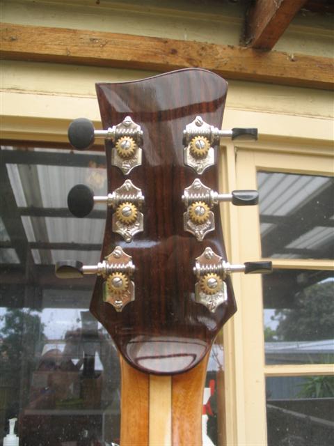

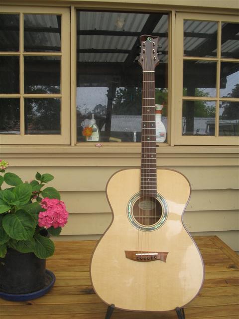

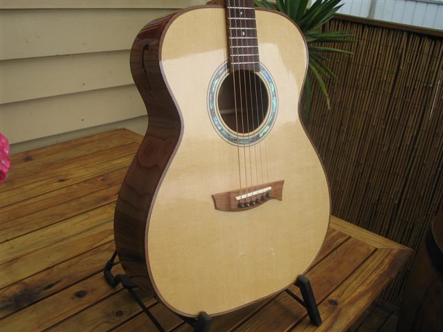

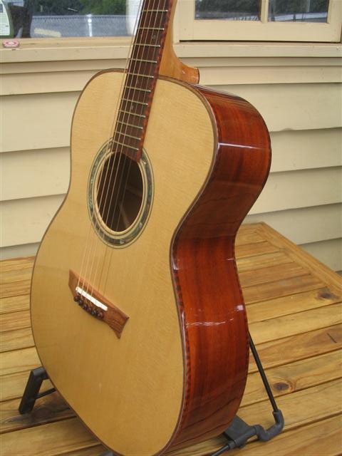

We finished this one today. A Mahogany/Lutz OM with Snakewood bindings. Scalloped bracing. Ubeaut Hard Shellac finish. Waverley tuners.
It was built to be used as a DADGAD guitar and string gauges at present are 56-13.
It's plenty loud and nicely balanced so it'll be fine for the Irish sessions that it will be used in.
Thanks to Dave White and Colin Symonds for their advice whilst planning this one.

I love it! I would have never thought to use snakewood bindings on a mahogany guitar, but it works beautifully! I like the bridge too...very unique.

Beautiful guitar and appointments, Bob. I completed a similar combo on an SJ last summer...the Snakewood bindings really set it off spectacularly.

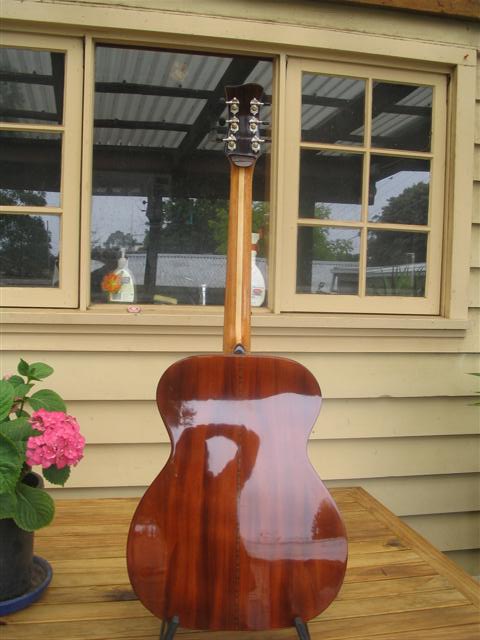

Great looking and I am sure sounding guitar Bob!!!!  Wow that hard shellac finish REALLY shines!!!  The reflections are amazing!
It looks like she has an X-braced back too.

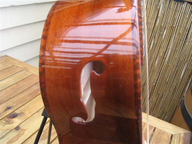

Great sound port. Looks fantastic, as usual.

That snakwood binding looks fantastic against the mahogany!

And the sound port looks great,I love it!

Congrats to you and your recipient. Gotta love those back of the headstock overlays, nice.
