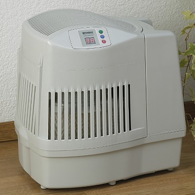

Rich my friend I run two humidifiers - a 12 gallon Sears w/digital display for the entire 1,400 square foot condo and a 10 gallon Sears w/digital display for the 126.5 square foot shop.  My shop door is always left open as well.
In Michigan in the winter with forced air heating it can get very dry and in the summer I have to dehumidify the shop.
Both of these units are in their third year of operation for me and they work very well.  I did have to learn to clean the filters, perhaps every 3-4 weeks, so that I was not constantly having to purchase new filters.  Thanks again to Bill for this!
And the digital displays are not accurate but they are accurate to themselves in that once you set "a number" that keeps your shop at the desired level, as indicated by outboard, calibrated, and multiple hygrometers, they maintain my place at very close to 45% RH.

The smaller unit has three fan speeds and an "auto" that will increase and decrease the fan speed depending on how far off the unit is set to what the sensor reads.  I leave this one on "low" at all times - this is the one in my shop.  Remember too that since I am humidifying the entire condo the shop unit has very little work to do.
The larger unit has 4 speeds and an "auto" setting.  One of the 4 speeds is "whisper" and is nearly inaudible but I set this unit on "low".
You can hear them but they are very quiet and what I hear more then any thing else is them turning on and off since I get used to it when they are on.
I have had many humidifiers over the years and I like these units very much.  IMHO all "wick" type humidifiers may not actually put out more moisture at higher fan settings.  They are a bit like turning on the heat in a car that is not all the way warmed up yet.  The higher the fan setting, the lower the temp of the heat being blown out.
I have found that "low" is a good setting for these units and I can dump as much water into the air here on low as I can on "med" or "high."  I think that the reason why this is is that on higher fan speeds the wick is less efficient in wicking up moisture to the top and middle of the wick.
When it gets around 0F out the larger unit has trouble maintaining and my place will fall to about 40%RH.  The shop unit then comes on more and all is well except my dog's hair sticks out in all directions.....

I should have mentioned that the larger unit I refill, completely since it runs dry, 3 times a day this time of year.  The bottle holds just short of 2 gallons.
The smaller unit I refill about once every day and a half so you can see who is doing most of the work here.
One of my other objectives was to keep the place humidified for the Flushtone show room and racks of guitars.
PostPosted: Fri Dec 28, 2007 5:45 am
Posts: 1667
This one keep me happy. So quiet ya barely know it's there. Large enough that it only runs maybe 10-20% of the time... Change the filters once a year...
It can be plumbed for auto re-filling, too....

It's a Sears unit; search their site or your catalogs.. It's on sale right now, too.
PostPosted: Fri Dec 28, 2007 10:04 am
Thanks again guys, and Grumpy - this is what I was hoping for, something I can pipe in so will take a run to Sears tomorrow. Thanks again to all of you for responding. YOu guys always rock !!!

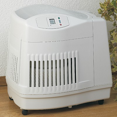

I have one like Grumpy's, but have never changed the filters, 4 years.
The one in my shop however got to stinking recently.  Had to change out the rancid water, so keeping them clean is a good point or you'll sometimes begin growing stuff that stinks.
My big one came from Lowe's Home Improvement, but it's a kissing cousin to the one pictured above.

Rich, to pipe it directly, you'll need to go to a home center or hardware store, and get a separate kit. They're complete kits, which will include the line and floats and everything. It's similar to the kits they sell to plumb a fridge or ice maker.
May I suggest you also add an overflow and run a larger hose(like a garden hose) to a drain, if you have one nearby? Aways good to have a little assurance <g>.
Brad, sounds like you need to at least get yourself one of these large ones. You'd go at least 3-4 days between fillings, and you'd likely save enough on power usage to pay for it in a year or two.
