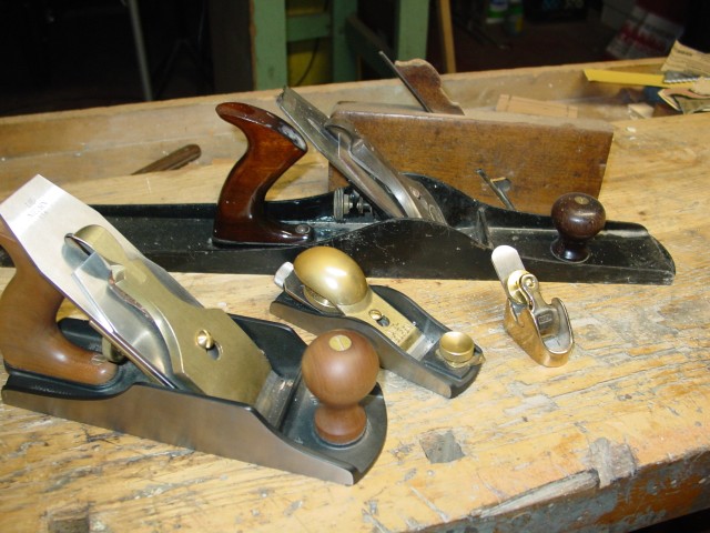

I just built my first Krenov style plane.  Love it.  I even think adjusting it is easier than a Bailey.  Building it took less time than fixing up a Bailey.  Hock sells a kit, but I did mine from scratch from the book Making and Mastering Wood Planes.  This book also has tips for use, sharpening, and tuning metal planes.
PostPosted: Sun Dec 16, 2007 5:37 pm
Joined: Tue Sep 25, 2007 5:39 am
Posts: 69
Location: Brighton, United Kingdom
I'm a complete beginner to woodworking, not just guitar making.
Consequently I've spent a fair bit of time making 'stuff' which isn't guitar-related the last couple of months in preparation of working with nice tonewood. The idea being to have sufficient chops when I start working with the 'good stuff' that I don't waste it due to sloppy workmanship.
I have to say one of my favourite tasks so far has been hand-planing. Took me quite a while to get the 'hang of it', but when you have a well-honed plane making tightly curled less-than-paper-thin shavings it's incredibly satisfying. Maybe that's just because I'm compeltely new to it, maybe not.
I picked up these two planes (18" and 22" I believe, though I still haven't got round to measuring them) for ?5 each in a local flea market.
The blade on the larger one needed replacing, but the one on the smaller plane was (very surprisingly) already honed to the 'ludicrously sharp' point and planed like butter. (Please note that's a martin-dimensioned OM behind them for scale)
They're made from some kind of hard wood, don't know what exactly but they both weigh and absolute ton and the soles are spot-on flat, the edges a perfect 90 degrees.
All in all, I'd say it was the best ?10 I've spent since I started down this guitar-building path. :)

I have quite a few stanley planes it takes some work to get them flat. I agree with todd on the blu belts from Norton. The first couple I flattened were with regular wet/dry sand paper. Someone told me about the blu belts, I tried them and will never use anything else for this purpose. They work great.
I have also bought a Vertas low angle block plane. Great purchase. If you are able to afford the vertas or LN planes they are truely worth it and you won't be sorry you did. Especially a plane that you will use alot like the block or a type 4.
I would buy the Vertas plane, and resell the Stanley.
my 2 cents
davido
PostPosted: Mon Dec 17, 2007 5:44 am
Posts: 3935
Although a flat sole may not be 'essential' on a plane, it sure makes using it a heckuva lot nicer in almost all work.
I bought a Record #4 as one of my first purchases more than 30 years ago. It was a while before I found out that it was essentially a 'plane kit': a set of parts that, with a bit of work, could be turned into a decent plane. Once I got it trued out and tuned up right, things went much better. I hate to think about how many acre-feet of wood I've removed with that tool, including doing all of my joining. Recently I got a Hock blade in it, and it's now even better.
My other favorite plane is my Veritas low angle block plane; the only one I've ever had that could consistently take shavings off end grain. I use it for all of my rosette work, as well as a lot of general purpose stuff.
For planing bone for nuts and saddles I use the old Stanley low angle, with the original iron. Sharpen it to a really blunt bevel, and it will hold up well on bone. The harder Hock irons tend to chip. I also have an assortment of violin makers finger planes, and one of the little Lie-Neilsen planes that was given to me, and gets a lot of use.
Even after all of these years of making instruments, I still enjoy using a well set up and sharp plane. Many of the things that people do with complicated jigs and routers, or even CNC, can be done pretty simply with a hand plane if you know how. When you make a wide variety of instruments, as I do, the flexibilty and precision of good hand tools makes a lot of sense, rather than filling the back room with a ton of specialized jigs. Besides, there is no smoother surface than a freshly hand planed one, and nothing glues better.
