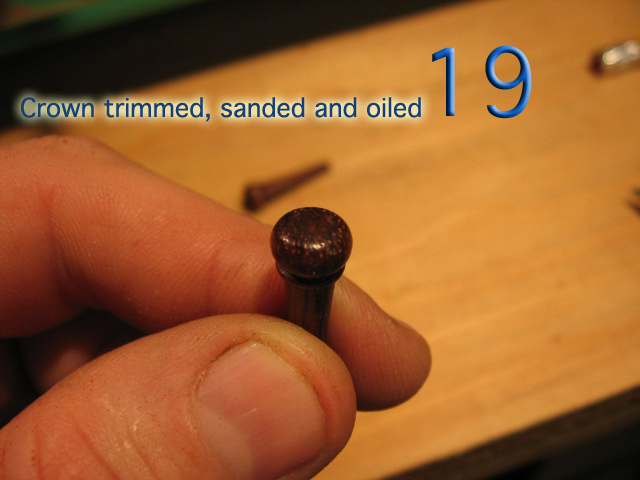

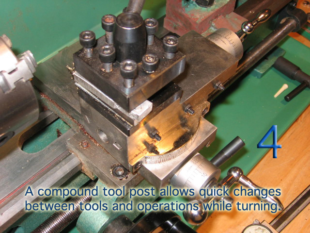

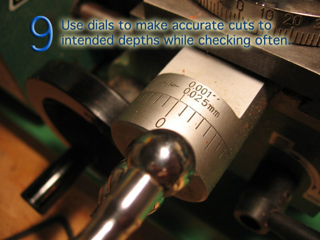

    Switched to Firefox from Safari on my MacBook and want to give these one more try.
Continued.....
PostPosted: Tue Dec 18, 2007 10:27 pm
Posts: 1041

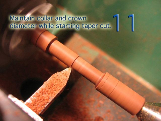

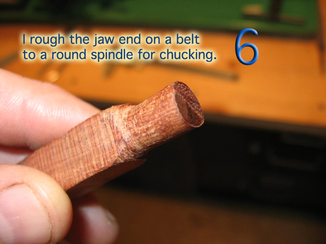

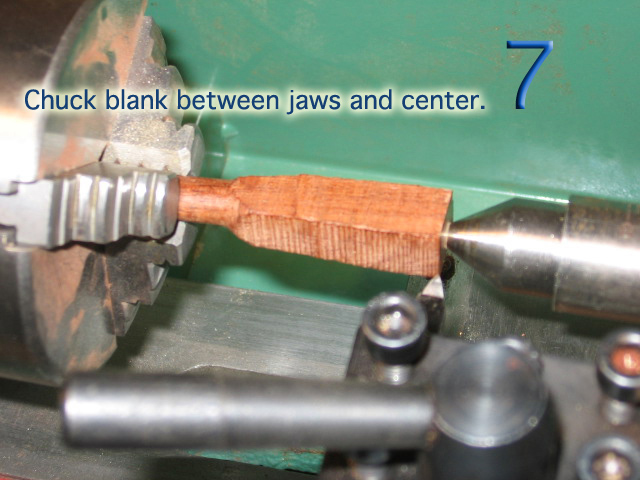

...Here are the final tutorial pics...

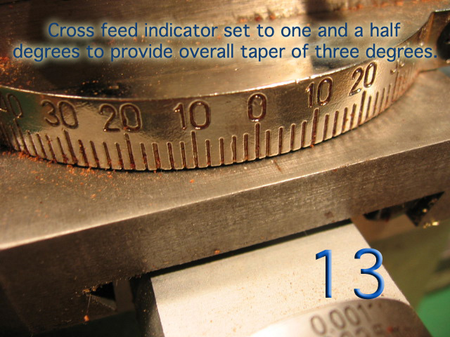

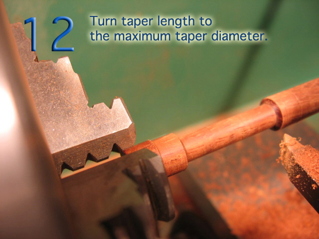

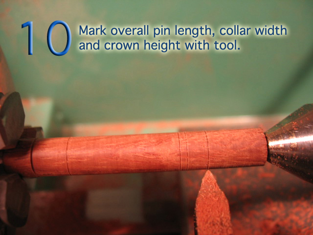

   Thanks for looking and sorry for the broad strokes, but this process can be adjusted to suit individual preferences and tooling.
Regards,
Kevin Gallagher/Omega Guitars
PostPosted: Tue Dec 18, 2007 10:31 pm
Posts: 1041
    It's possible to get good results using a wood lathe and steady rest, but the taper and diameters are important and accuracy is necessary to provide a good fit and solid integration between the pins and the bridge.
   For that reason, a machine lather with cross feed are the best choice.
Regards,

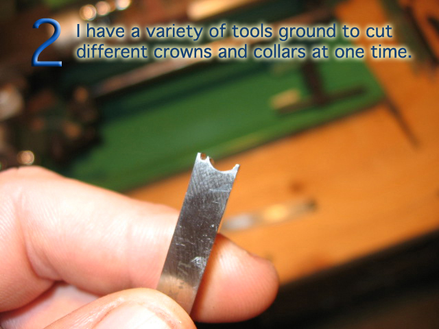

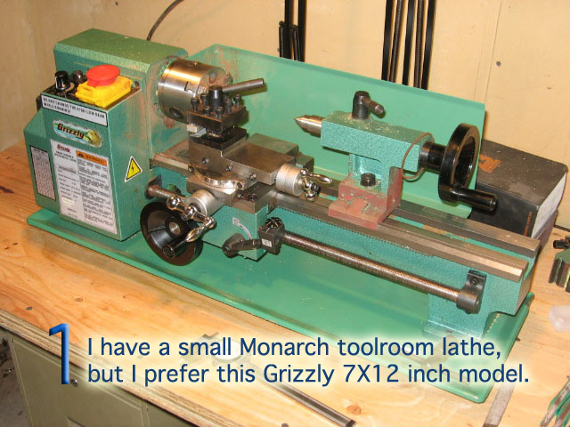

Thank you Kevin. I have been wondering about this very thing. Turning pins out of woods that match the body binding etc has been a goal of mine and I could not decide what kind of lathe to buy.
I am curious about the specially ground head cutter. Did you do that or did you have it done?
Do you have the model number of that Grizzley lathe?

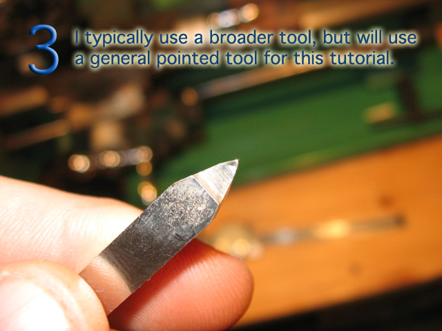

Thanks for taking a look to those who have. My intial post attempt seems
to have gotten more looks than this successful one, but this one is a little
more fun to look at than all those funny little question marks.
   I apologize again that it wasn't nearly as detailed as it could have been,
but we could post photos all day long about pretty much anything we do
in our shops.

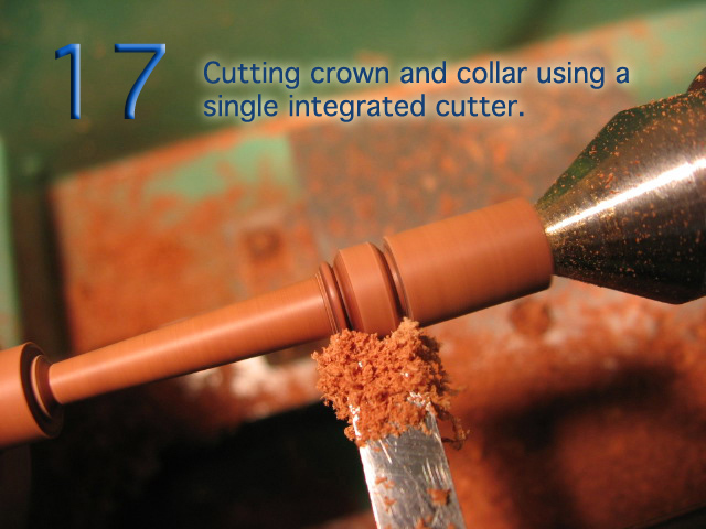

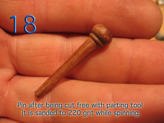

JohnK,
I just cut those specialty cutters out of high speed steel cutter blanks. I
cut this one just for the tutorial, but i have about a dozen that give me
different crown and collar dimensions and radii.
I also have a one pass cutter that cuts the entire pin from cap to tip in
one operation. I have only use it a few times since it really pulls on the
small diameter piece. Results are good with it, but i've found that I have
to chase the taper to true it up after using it anyway so I just use a
method close to what is pictured here.
That little Grizzly is nice and small. The model number is G8688 7" x
12" Mini Metal Lathe. It's nice and solid and the cross slide and steady
rest are true and fully adjustable as far as gib and nuts go. The turret
post works well, too.
   The only accessories that I'd recommend picking up right away are the
drill chuck with an MT#2 taper for drill on center from the tailstock and a
nice slection of 5/16" HSS cutter blanks and precut cutters.
Regards,
