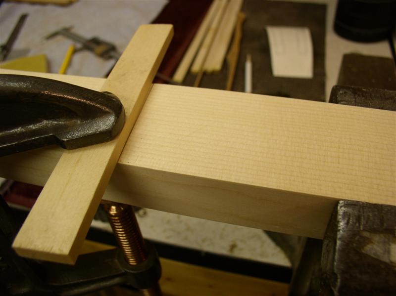

Below is a fairly quick and accurate method of making an X brace using a laminate trimmer, 1/4" bit, table saw and a Luthier Suppliers brace radiusing jig.

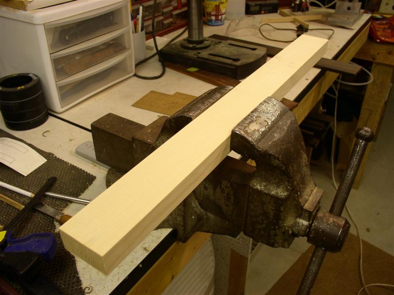

First thing I do is square up all four sides of my brace stock.

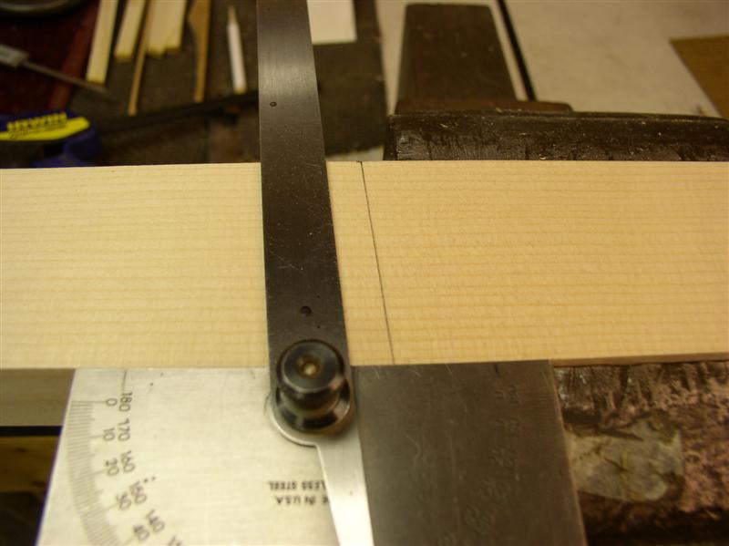

Then I mark were I want to cut the lap joint. Here I am using a 96* splay for my OMFS model.

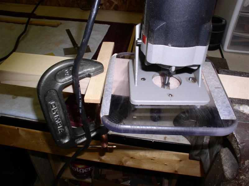

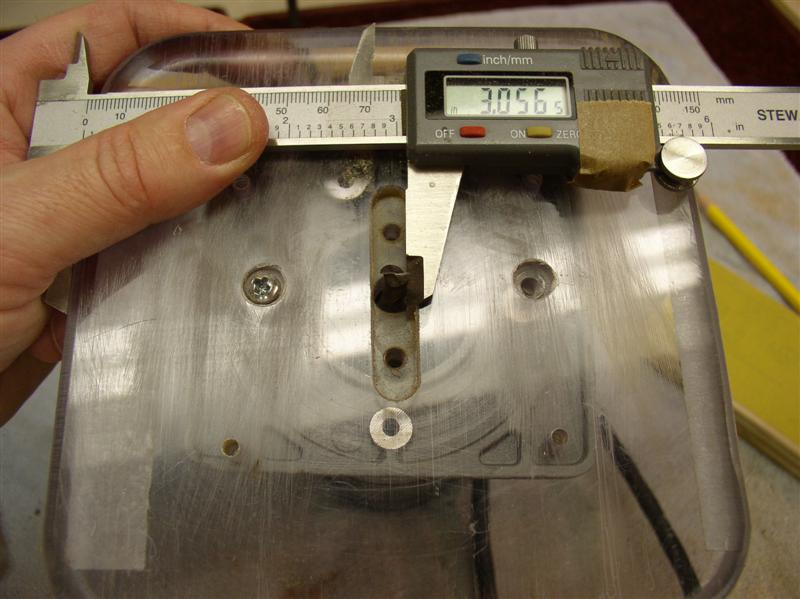

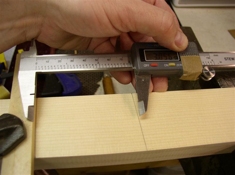

Next I measure from the out side of the bit to the edge of the base, this will give me the distance I need to place my fence from the line I want to cut.
Here I have clamped on a temporary fence then check the deapth of cut.

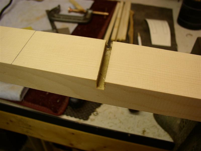

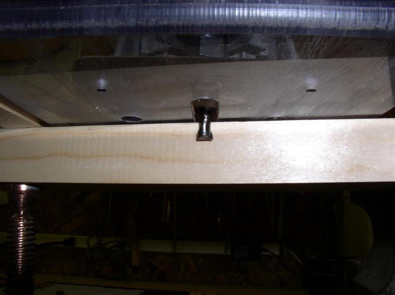

Next I cut the 1/4" channel.

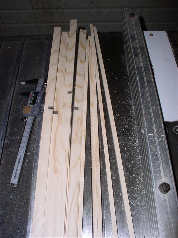

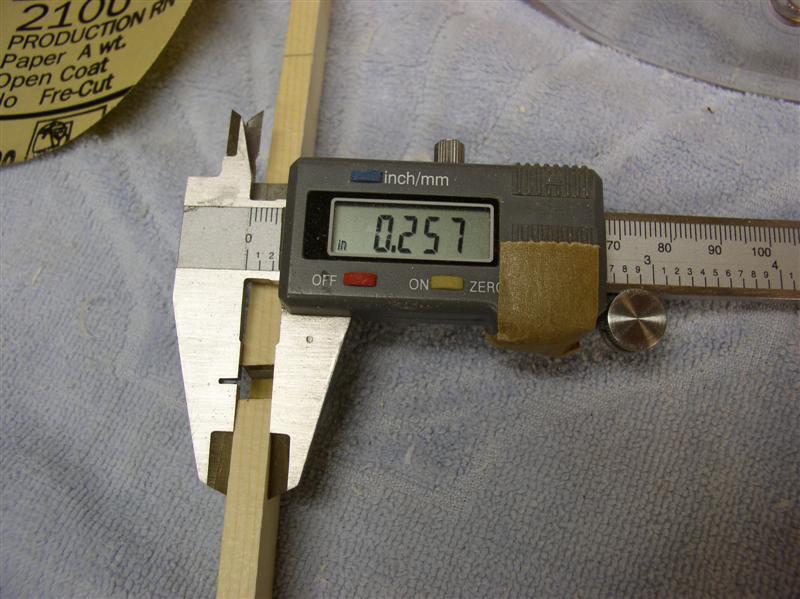

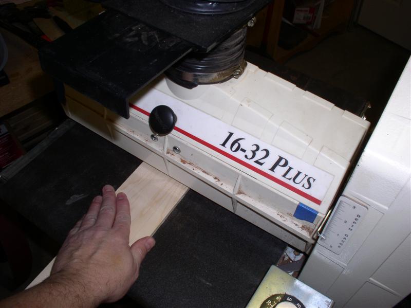

Next I take the brace stock to the table saw. I want to cut my braces just a tad wider than 1/4".
Now I will sneak up on the final thickness of the brace using my drum sander.
I am shooting for .250, getting close.

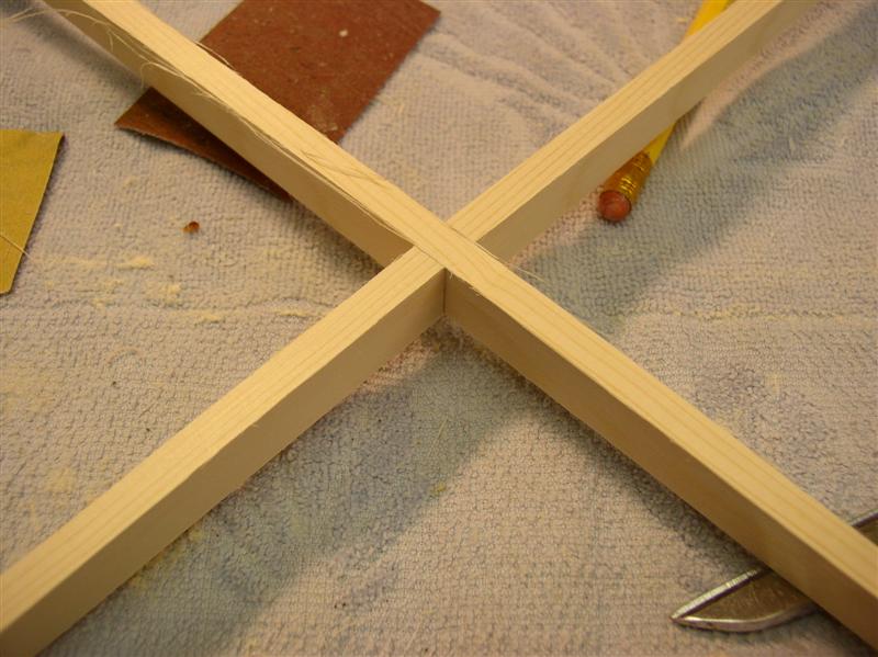

The last few thousands are taken of using 220 to give the brace a nice clean appearance.

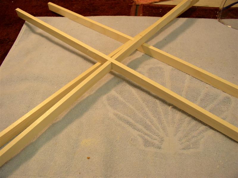

Perfect fit!

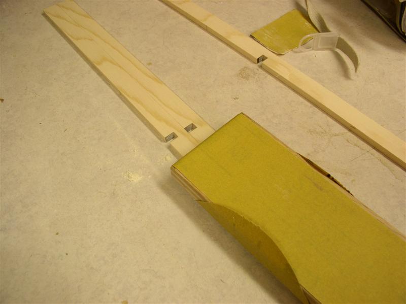

The last thing I do is establish the radius. Some people use a sanding dish, some mark the radius and plan it off, I use one of Luthier Suppliers radius jigs. Love this thing!
Finished!

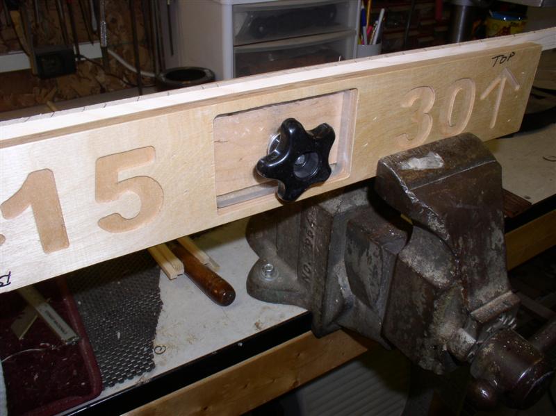

That's one heafty looking vice you got there. Do you use soft jaws of some sort when holding parts?
Also, are you a lefty? You have your table saw fence on the opposite side that I see most (not that there is anything wrong with that)

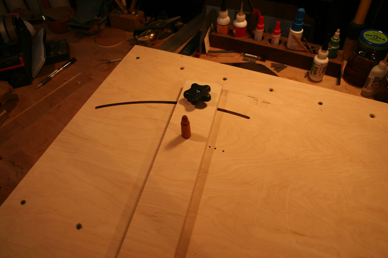

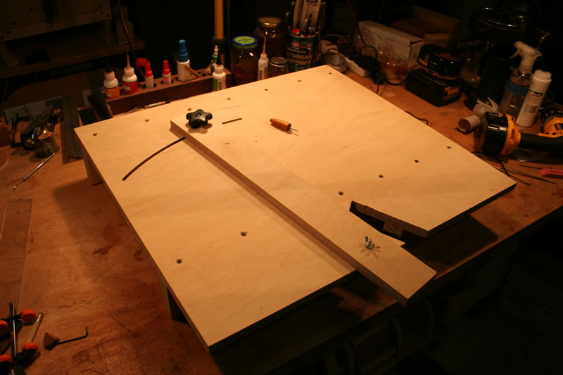

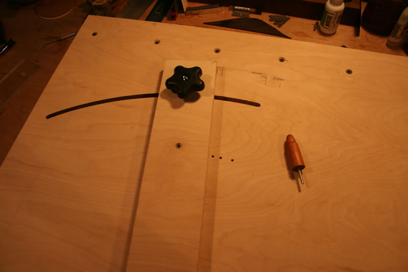

[QUOTE=Terence Kennedy] That's great Lance.  I like your slotting technique.  I built a slotting jig way back that works fine but it only does one angle.  Your idea for measuring the router bit-base edge distance is way too simple!  BTW is that the Grizzly G0512 edge sander?  Has it worked well for you?Terry
After seeing yours I actually built an adjustable version of yours. Not only can you adjust the angle, but you can also replicate angles exactly over and over again. I used a drill bushing and a registration pin.
The pictures should be clear.
PostPosted: Sat Dec 22, 2007 2:52 am
Nice looking jig Brock, but I'm confused with one thing.
where do you put the brace stock? It sure looks like you'd run the braces against the fence but where does the router run? It looks like it runs more parallel to the fence rather than perpendicular.
I'd like to make something like you've made and I have an idea of how I'll do it, just thought you'd explain the "cutting" a bit.
PostPosted: Sat Dec 22, 2007 2:57 am
Sorry,
I put it under the front of the table. There is a fence spaced 1" back from the edge of the front. I place stop blocks in there and clamp the braces to it.
The only thing you have to do is make sure and put a sacrifice piece behind it or you will get some tear out as the router leaves the stock. (and ... I suppose this is obvious, but the sacrifice piece needs to be of a uniform thickness so you don't mess up the angle.)

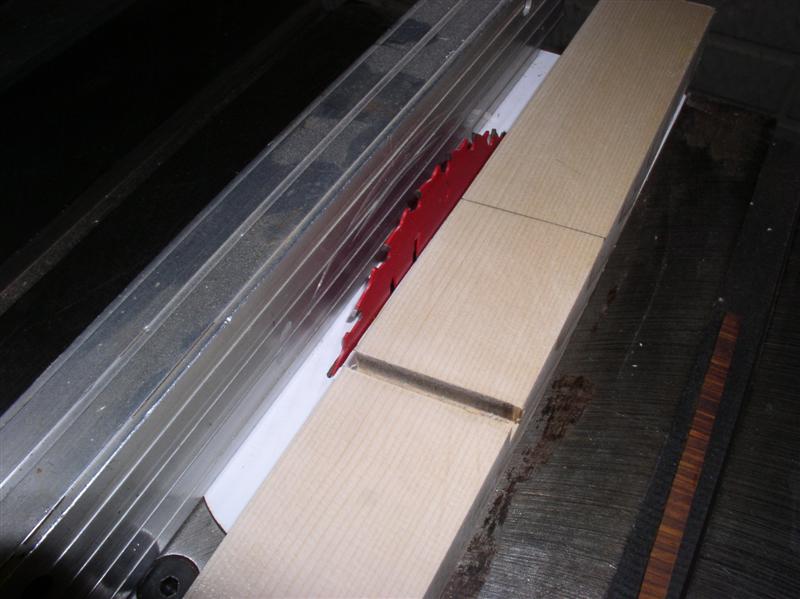

... Why use a router to make the lap joint, when you have a table saw right there? Set the miter gauge at the angle of your X brace, set the blade height, and cut. Use whatever blade is in there, and nibble the waste. Use a drill bit as your guide to the width if you wish to pre-cut the notch as you did here.
The router works, but it's one more tool to set up, take out, more clamps, etc... You're already at the table saw.
