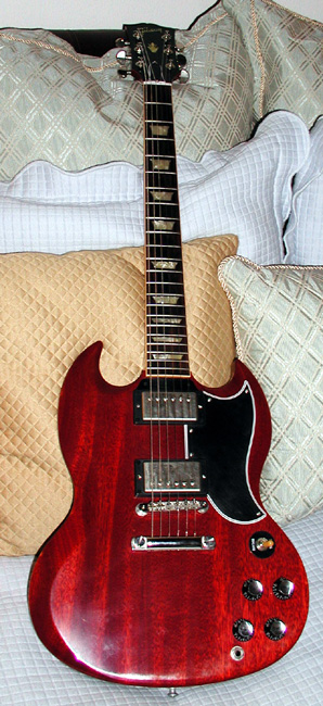

So, just out of curiosity, what would be the wishlist of things included in both a Les Paul and SG plan if by chance one might be of a mind to make some?

When it comes to an SG plan I think one based on the 62 sg or les paul as it was known before the name switch Like below. A classic

OK - I have been an acoustic player for almost 40 years.  I wish I had that much talent...  I lnow what a Les Paul, Strat and Tele are but I don't know what an SG is.  Can someone enlighten me?

An SG is an SG. It stood for Solidbody Guitar. It's Gibson's slightly less popular model. Les Paul used to have his name on that one, too, but he wasn't fond of some of the construction details (like the worst neck joint in the biz...).
Walden the pic is above. Thats an SG. As played By angus young of ac/dc, Tony iommi of Black sabbath and pete townsend of the who at live at leads, Frank Zappa, Duane Allman and many others. Its one of their most affordable models making it cheap enough for most starting guitarist to get their first gibson. I just love the shap and look.
