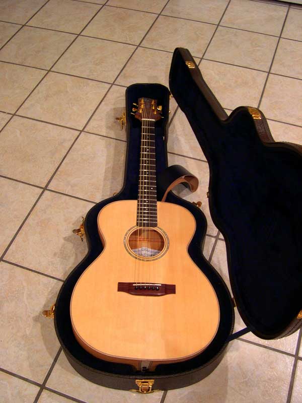

Well after six years of building classical guitars, I figured it was time to finally tackle my first steel string. I strung it up this week and was quite surprised at how good it sounds. I used the John Mayes advanced voicing DVD's and basically built an exact replica of the top in those DVD's, and I used the OLF SJ plans for the rest. I haven't put a finish on the guitar yet because it's way too cold for me to spray now, so I ended up stringing it up with no finish.
Some of the biggest crossover lessons learned:
- A Dovetail neck joint can be quite tricky. Next time I will try the standard bolt-on M&T.
- I really enjoyed building the box in the mold. I'm going to incorporate this into my classical building.
- Next time I will install the trussrod so it adjusts at the headstock, not inside the box.

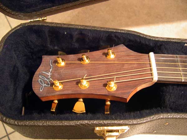

- Inlay is tough--I will pay somebody next time to inlay my scipt logo. The fret-dots were easy.
- Finally, setup was a little tougher on the SS. I still need more work here. I didn't have any of the radiused tools for sanding frets, therefore there are slight buzzes on the outside strings. I still need to fix these.
Here is a link to a montage of some songs I recorded. Overall I was very pleased with the sound. The clip doesn't do justice--it's just a video camera pointed at the guitar. Disregard the playing errors and mistakes, I'm a little rusty on the SS guitar. Also, the tuning errors are from my altered tunings, not the guitar. I still need to figure out what gauge strings I'm going to settle on.
SS guitar
Thanks for looking!

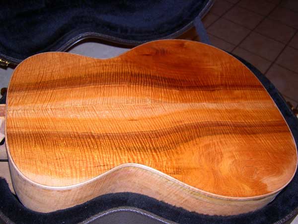

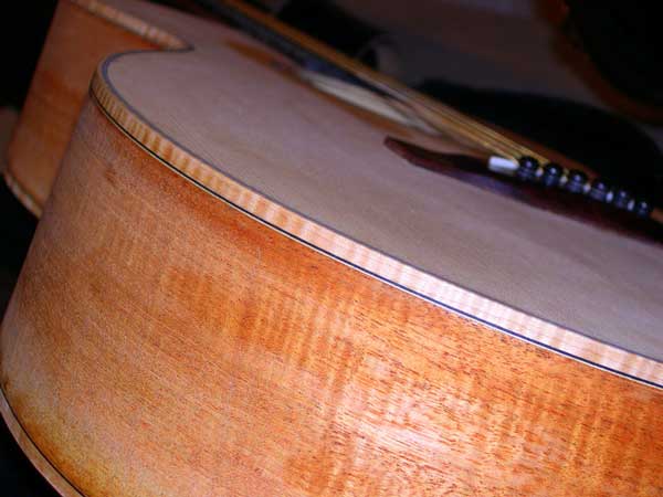

Thanks for the support fellas, here are a few more details (and pics). The top is spruce from Bob C. (sorry I can't remember what species I bought, it was about 3 years ago). The back and sides are also from Bob, figured Honduran Mahogany. Besides the killer looks, I really must say mahogany is quickly becoming one of my favorite woods as a player. I just love the sound of it. I have mahogany guitars with both spruce and cedar tops and they all sound great. This one really has a complex, woody tone--hard to describe, but the seperation of voices is very clear and even across registers. Flamed maple bindings (also from Bob). I can't wait to get it finished, I think the grain on this will be awesome.
Oh, and I almost forgot--my bible during this build was Robbie O'Brien's DVD's. There are a lot of techniques from his SS dvd that I learned and will incorporate into my classical building. There are a million ways to skin a cat, and a lot of what Robbie teaches just makes sense to me. Thanks for looking!
I'm embarassed to show my inlay work but it is what it is until I get better skills. Somehow I never learned to inlay from building classicals!
