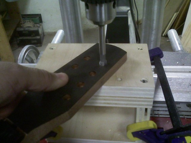

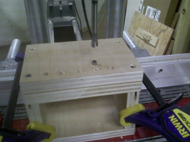

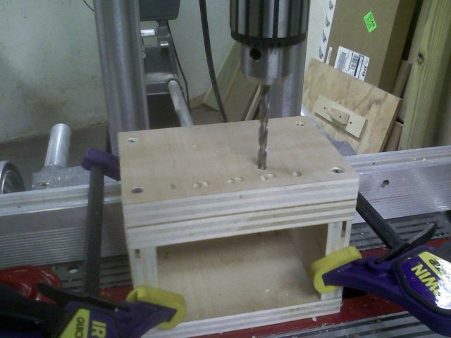

OK here are some pics.
First drill the 1/4" hole.
Second, Place the 1/4" pin in the hole and replace the drill bit. Remember, don't move the block.
Then place the headstock on the pin and drill the bushing hole.

I still use the drill press. I tilt the table until the drill bit slide smoothly through the jig hole. In my case, that usually involves no tilt at all because I have a flat headstock. If I ever to an F5, I might use the hand drill or perhaps, I'll use the stewmac jig to drill the holes in the backer block and just use the pins as you suggest.
