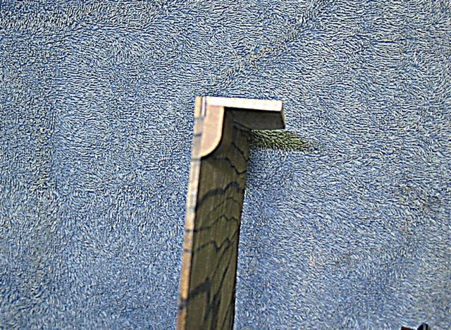

Sorry for the poor pix, but here's the idea; BWB full 1/4" tall purfling and mahogany binding mockup. (Black and white ebony side scrap from zootman) I see no problem here...

If your binding and purfs are 0.150", then it looks like the 'side' in your pic is about 0.135...is this accurate?
Anyway, in the pic you certainly have plenty of lining left.

Your sample makes it more understandable.

Hi John,
In this mockup, the sides & top are both .100" When I glued the binding on, it stuck out a bit, cuz I didn't have the right cutter (topic of another thread...) The channel is only .120"
