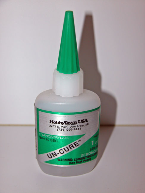

Hobby stores sell this:
It's used for softening and dissolving CA and is even used to clean it off your hands.  Now caution, it might eat nitro, I don't know.  But perhaps if you have some scrap to test on, put some on a soft cloth and see what happens.  It takes a bit of time, 10 seconds+, to start to work.  It also smells like someone cut the cheese in the room......
