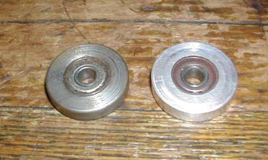

The bearing on the right is what I made up.
I made mine from aluminum because it's all I had at the time. The LMI wheels look like free cutting steel, I have both on hand now.
Anyway, I have some bearings that fit my LMI cutter left over from modifications I was trying to make to a P.C. edge guide.
Let me know the OD that you need and I'll make up a wheel and press fit a bearing into, just like the one above.
I could have it out to you tomorrow.
Louis
