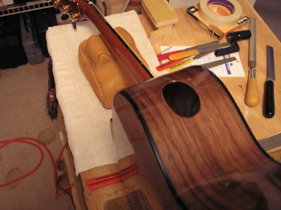

John, I add soundports after the box is closed as I like the ridgidity that the closed box gives when cutting the hole. You can mark and drill around the circumference then clean up with file and sandpaper before gluing on the intenal laminate or do what I do and used one of those piloted holecutting saws that fit in a drill. I use one on slow and very light pressure, clean up the edge then I use three layers of 0.6mm laminate on the inside. This one is in walnut with walnut and maple laminates on the inside.

John, On my last guitar I cut the sound port after the box was bound,filled,sanded,and sealed. Also I sealed the edge of the port with CA. I pretty much did it like Colin.
