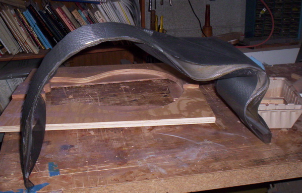

Here's the bag that started the wheels spinning... It's LexLuther's... I'd buy some, but, they are expensive, the available sizes don't quite suit what I have in mind, and I don't feel like waiting 2 weeks for them to arrive. Besides, I'm a roll your own kinda fella. Why buy what I can make and then customize further, right?

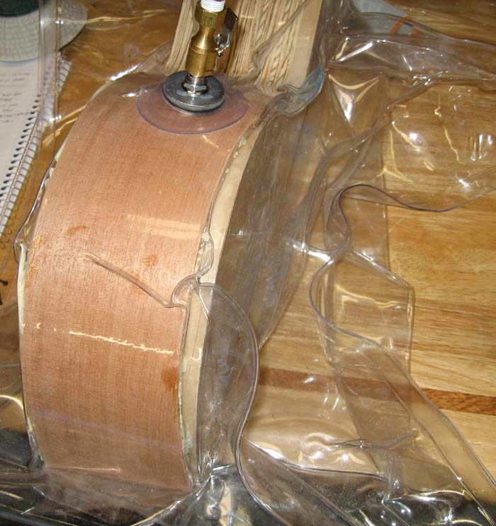

woohoo! Local hardware store had 30 mil vinyl....! Truck stop had screw on tire valves.. Lumber yard had both mastic, and butyl.
Couldn't find a Tap Plastics store anywhere, though <g>
 My little town surprised me today.
Off to the land of vacuum assit.

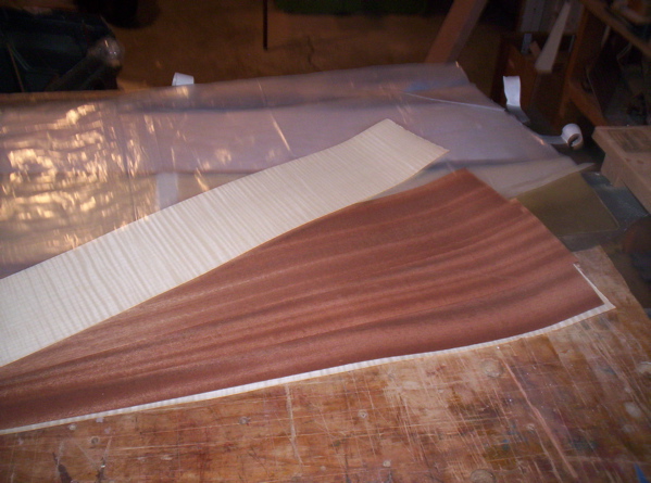

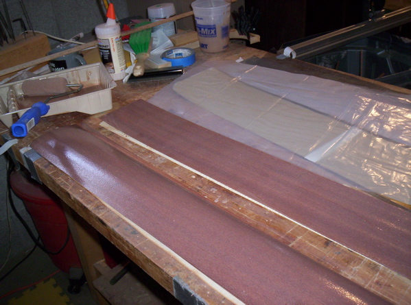

Mario, Are you laminating sides? If so consider making a small bag to slip the laminates into external to the mold. It works better.
PostPosted: Sat Dec 08, 2007 10:54 am
Posts: 1667

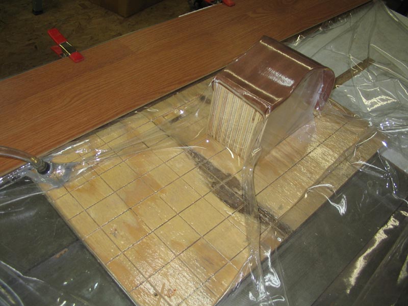

Ken, no, not quite laminated sides. I 'double' my sides in the upper bouts as reinforcement for the soundport. Usually a solid piece that matches the ribs.
Now, on this current one, a quilt maple 12 fretter, we want to see "purfling" lines inside the soundport, so I needed to laminate a mahogany/maple/mahogany/flame-maple veneer sandwich.
All done, thanks to the help here. I;ll rwefine the setup later, but it worked well last night!
Can yuo explain what you're trying to say, though, please! i don't quite grasp it, and veneering like this is new to me.

So, here is my very quick and even dirtier vac bag for bracing tops and
backs.
I use the West Syst. film and "mastic putty on a spool" (that's the yellow
stuff).
I take one piece of film, fold it, seal the edges with the mastic, seal
around the vinyl hose at the same time, plug it into a really crude little
piece of pliwood with holes and grooves, the other end to a compressed
air venturi gizmo, plug 'er in and let it do it's thing.
I like the West Syst stuff because it's really tough and very thin, so it
conforms around the parts well. I also like it better than the opaque
rubber membranes because you can see if a brace has tipped or isn't for
some reason behaving (I prefer my unwrapping surprises on Christmas...)
I seal the bag with a piece of aluminum angle clamped to the edge of my
bench. I use a strip of closed cell neoprene foam weatherstrip tape(the
black stuff) along the clamped edge.
When I'm using a dish for the shape, I'll put it in the bag when I'm doing
the glue up. Otherwise I'll just back up the top or back with a piece of
stiff cardboard and let the braces pull the top to their contour.
Not very scientific, but hey, we're not building pianos!

[QUOTE=grumpy] Ken, no, not quite laminated sides. I 'double' my sides in the upper bouts as reinforcement for the soundport. Usually a solid piece that matches the ribs.Now, on this current one, a quilt maple 12 fretter, we want to see "purfling" lines inside the soundport, so I needed to laminate a mahogany/maple/mahogany/flame-maple veneer sandwich.All done, thanks to the help here. I;ll rwefine the setup later, but it worked well last night!Can yuo explain what you're trying to say, though, please! i don't quite grasp it, and veneering like this is new to me. <div style=": ; width: 28px; height: 28px; : 1000; display: none;">
You have a huge set up to make a little bent lamination. It works okay but can get some tenting over the laminations if you are not careful. What works better is to make a small bag (or buy one) that you would slip the veneers into and bend it over the form with your hands, then pull the vacuum and it stays at that shape. The bag is outside the form so it only needs to be 6 X 20 inches or so. When the vac is pulled, the veneers get sucked together and pressed with out any chance of a void.
But hey, you got something that works fine there and that is what counts. Can't argue with success! Welcome to the wild world of vacuum bagging.

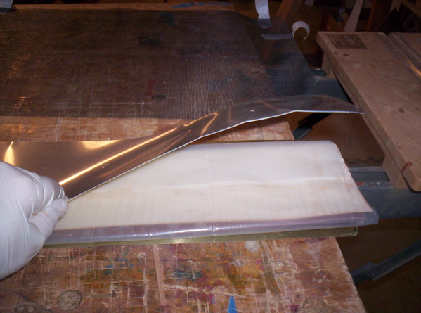

I should add that I put my veneers inside plastic sheet so no glue squeezes out making a mess of the bag, then surround them with bleeder cloth (nylon hardware screen) and then into the bag. The bleeder cloth needs to make contact with the exit hole for maximum evacuation of air. Etcetera and etcetra.
PostPosted: Wed Dec 12, 2007 12:54 am
Posts: 1667
Ken, do you have photos you can post? I'm not "getting" it. If I place the laminations in a separate bag, outside the form, and vacuum that, they won't take the shape of the form. A photo would clear things up greatly. And be much appreciated!
Yessir! <bg>. It's the whole piece of vinyl I purchased. I just used those pieces of laminated flooring(great jig stock, and I grab scraps everywhere I can) to seal the 3 open sides for this "run". I left it full size, and my pump evacuated the whole thing in around 20 seconds, so it worked well, and there were no voids at all; very smooth on the form. I found some swimming pool liner adhesive yesterday, so will make the bag permanent soon. At the size i have there, I can just get a dish in if I want to try pressing braces or making a laminated back or something, so I think it'll stay that size. Didn't seem to hurt the little job here...
I need some screen. Not long ago, I found something that would have been perfect, but damned if I can remember where I saw it. It was like expanded metal, but in plastic. The stuff would be ideal as a mesh...
 Looking forward to photos and clarity.... thanks!

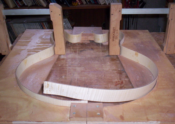

My way of doing it consists of using the bag "external" to the mold. When the vacuum is pulled, the bag can actually be removed from the form and it will stay in that shape. I just leave it until it dries though. Here are some photos
PostPosted: Wed Dec 12, 2007 6:48 am
Joined: Sun Jul 31, 2005 2:40 am
Posts: 210
uggh sorry about the format of that last post.
Ignore the aluminum, I have abandoned using it as it makes things worse.

Ken, still no idea how you get the laminates to conform to the form. Is the aluminum the form, and you then slide the bag and laminates over it?
At any rate, what I did worked. If I get to building plywood guitars, I'll just use the same form, but whole.
